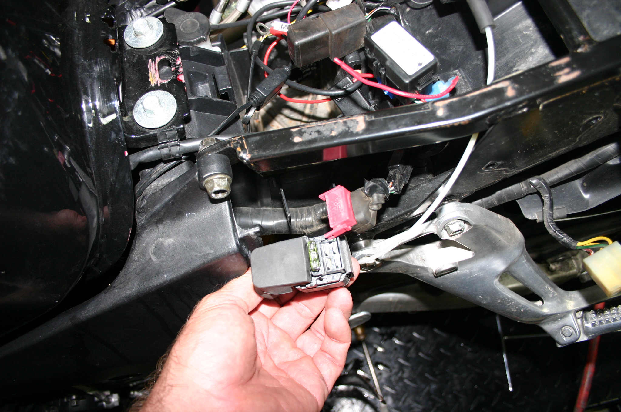

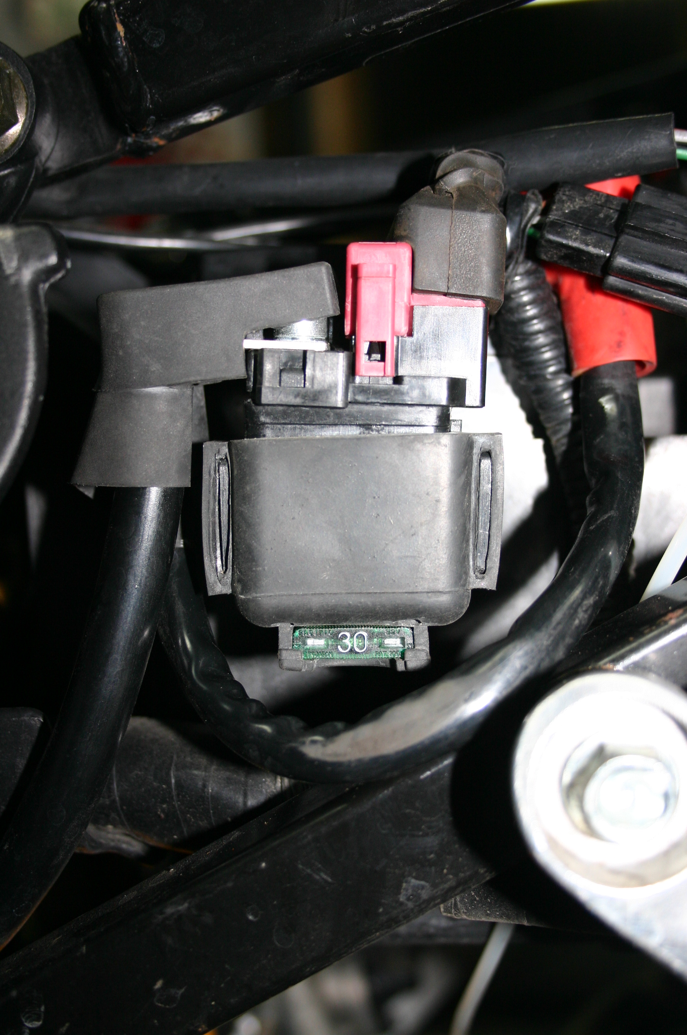

dunedain Posted August 19, 2006 Author Posted August 19, 2006 Aight then! I found a 30 amp fuse and it was fine but if you look at the picture you can see that there is another 30 amp fuse under that little pink rubber cover. It was shot. Replaced and we in the business. Too early to tell if it fried anything else but everything seems to run and work fine so I'm calling it good. Moral: If you jump start your battery backwards (due to ......uh the sun being in your eyes) then the fuse under the pink rubber cover under your tail section is the place that pops first fuse. Quote

gharknes Posted August 21, 2006 Posted August 21, 2006 Aight then! I found a 30 amp fuse and it was fine but if you look at the picture you can see that there is another 30 amp fuse under that little pink rubber cover. It was shot. Replaced and we in the business. Too early to tell if it fried anything else but everything seems to run and work fine so I'm calling it good. Moral: If you jump start your battery backwards (due to ......uh the sun being in your eyes) then the fuse under the pink rubber cover under your tail section is the place that pops first fuse. If you had read my posts I told you to check this one as I thought you overlooked it...............glad you got sorted Quote
