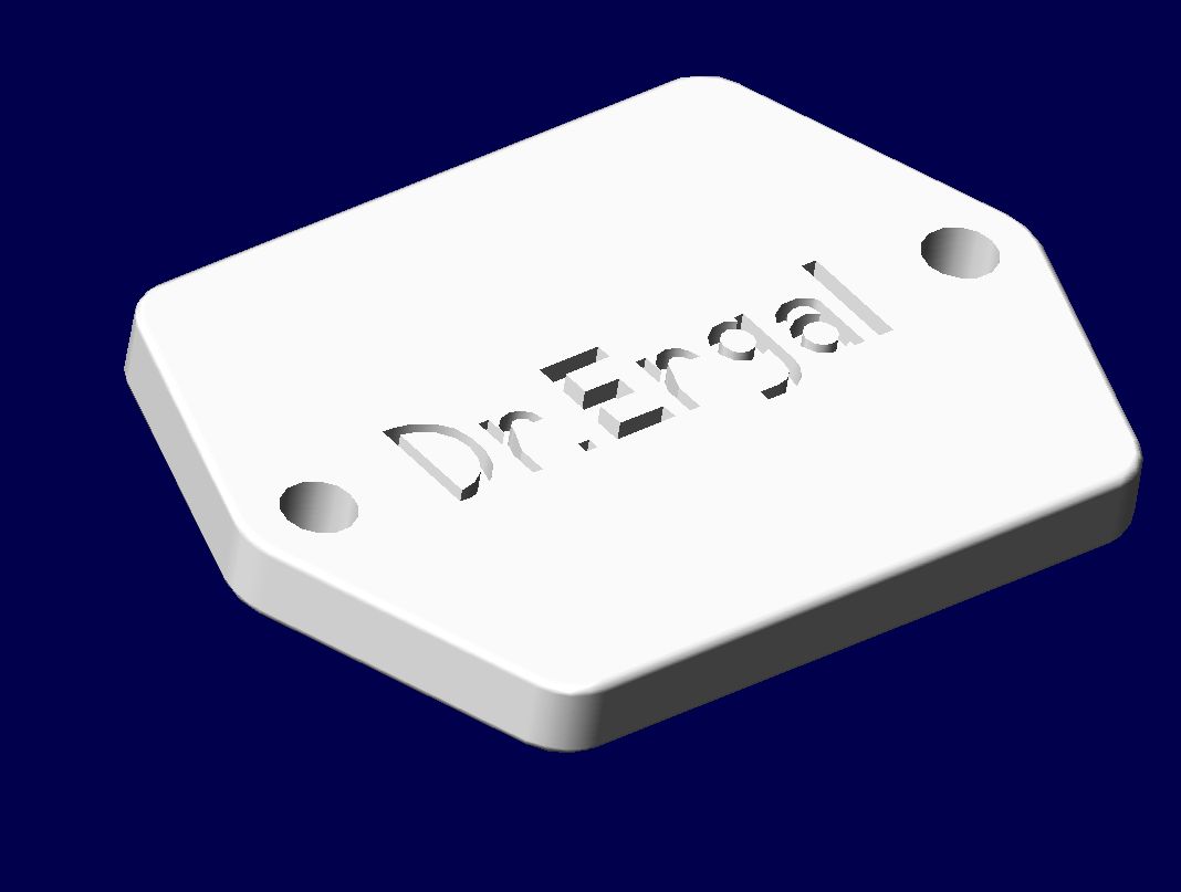

Dr. Ergal Posted September 19, 2007 Posted September 19, 2007 I'm not involved in races, so my PAIR valves cover plates are in progress (by a AVIONAL 2024 plate) Another nice news coming soon Quote
