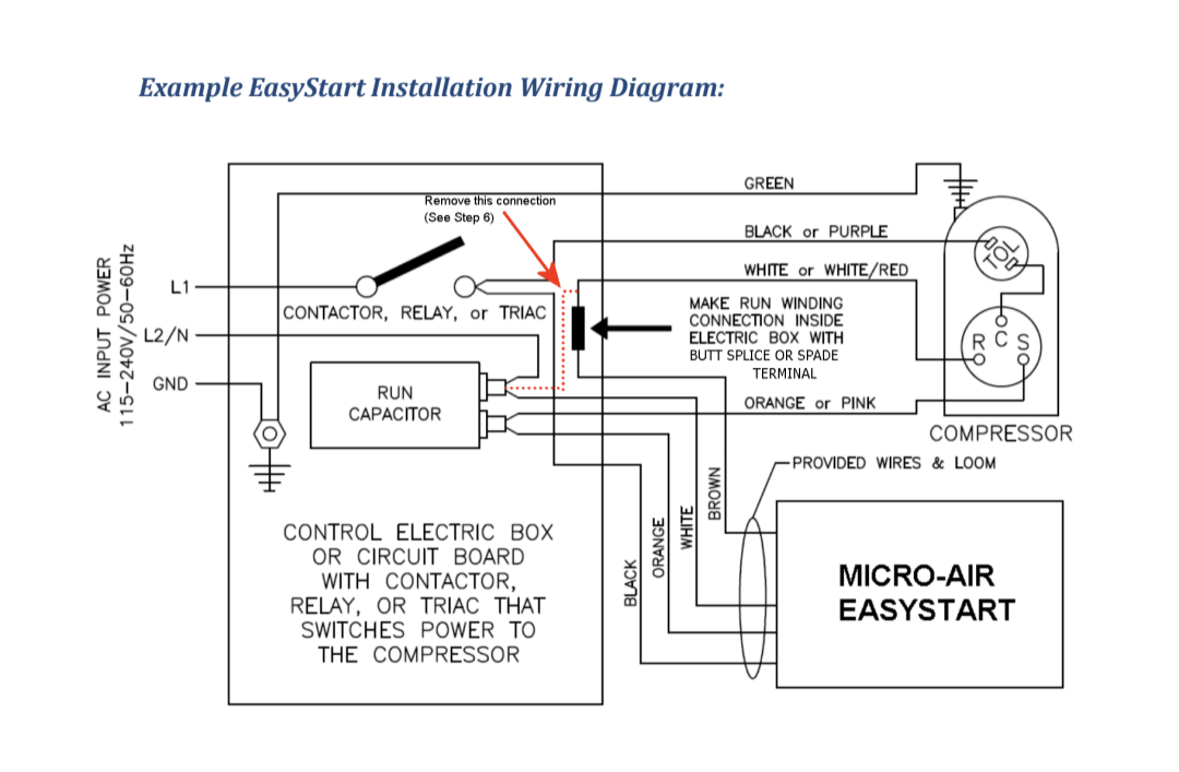

XXitanium Posted March 10 Posted March 10 On 3/6/2026 at 2:27 PM, 02XXCA said: The one at this link will work with that unit, https://invertersrus.com/product/micro-air-easystart-flex-soft-starter/ https://invertersrus.com/wp-content/uploads/2020/02/EasyStart_364_368_Installation_Manual.pdf Quote

Zero Knievel Posted March 24 Author Posted March 24 Finally got it installed. No pictures...sorry. It wasn't horrible to install, but.... It sucks when people in the household think planting shrubs next to the outside unit is a good idea. 10+ year old wire schematics on the inside panels of the unit are freaking hard to read...even with my old fart reading glasses. A device which has an end that is always supposed to point down should be labeled as such on the casing. Otherwise, my first hiccup was installing the module upside down (wire harness comes out the bottom). I didn't see an instruction on this until I went to do the wiring. The device comes with a double-sided glue patch and self-tapping screws. I had to re-route the wires back out, remove the screws and pry the module off the inside wall it was mounted to. To do the wiring, I had to go to their website. The Trane-specific diagram wasn't that helpful. The general "all purpose" diagrams were. They showed the different types of setups, and once you found the one that matched yours, the instructions made a lot more sense. It takes about 6-8 starts for it to fully "learn" your system, but when I tested it, the first start was practically silent by comparison. I heard the fan start and then the compressor...which was quieter than the fan. Interestingly, I'm pretty sure we got the current unit after the whole house generator, but our whole house has a 200A service. The current some of these suckers draw explains why the lights dim when it kicks on. Quote
