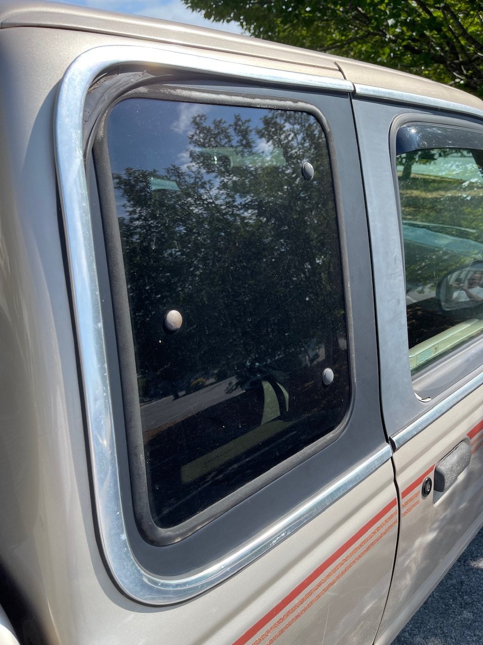

Zero Knievel Posted August 9, 2025 Posted August 9, 2025 Have this issue with the truck. As I recall, something caught it and pulled it loose. I’d like to “fix” it, but replacement parts aren’t available. It appears to just be a trim piece. I would think I could remove it and glue it back on, but I suspect it was an inclusive piece…which is now separating. Any ideas on what to use? Quote

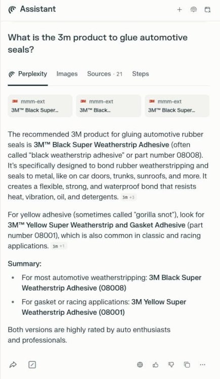

SwampNut Posted August 9, 2025 Posted August 9, 2025 The rubber shrank and pulled, common. There's a 3M adhesive specifically for that (of course). However you're fighting a battle with the shrinkage that you may not win. My first course would be to inspect the area for the ability to cut this, glue it, then fill the cutout with generic EPDM seals of the right size. You can buy them in dozens of shapes and sizes. Quote
superhawk996 Posted August 9, 2025 Posted August 9, 2025 As Carlos said, it's probably a loosing battle. I'd probably cut it near the top where it's not noticeable and sealing isn't a huge issue then put a dab of sealant in the opening. Quote

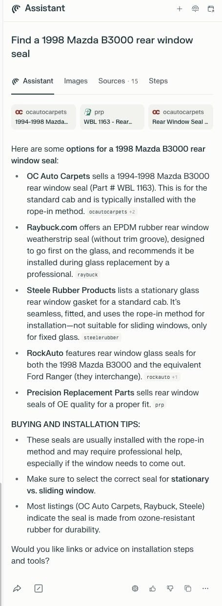

SwampNut Posted August 9, 2025 Posted August 9, 2025 I can't remember the exact year, but that's probably close and the same. Anyway, it seems the part is easy to get. Quote

Zero Knievel Posted August 10, 2025 Author Posted August 10, 2025 (edited) I will clarify. This is a trim piece and not part of the window. As such, I’m inclined to use a heat gun to completely remove the piece, clean the mating surface and (optionally) re-glue it onto place. Better than leaving it loose to get caught on things and ripped off. Edited August 10, 2025 by Zero Knievel Quote
blackhawkxx Posted August 10, 2025 Posted August 10, 2025 14 hours ago, SwampNut said: I can't remember the exact year, but that's probably close and the same. Anyway, it seems the part is easy to get. Look at his photo, it's a side window, not rear. Quote

superhawk996 Posted August 11, 2025 Posted August 11, 2025 On 8/9/2025 at 8:34 AM, superhawk996 said: As Carlos said, it's probably a loosing battle. I'd probably cut it near the top where it's not noticeable and sealing isn't a huge issue then put a dab of sealant in the opening. I just noticed that it doesn't appear to wrap all the way around, looks like it ends at the front edges. If so, you shouldn't need to cut it as long as the top edge will slide rearward. And it doesn't appear to be acting as a seal, just a cosmetic trim, so no sealing needed. Quote
