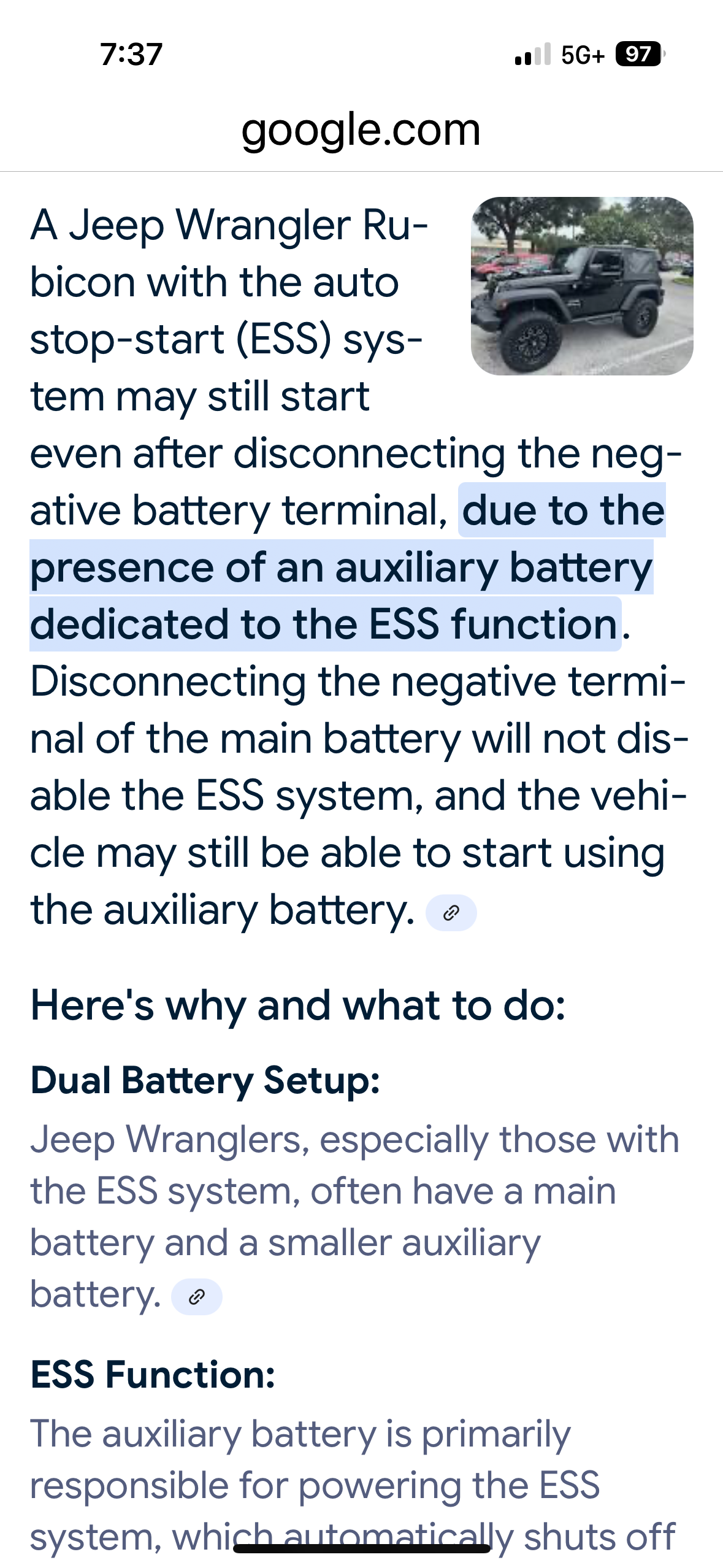

DaveK Posted August 5, 2025 Author Posted August 5, 2025 Myth busted. Took the negate off completely and she fired right up. Then found this. 1 1 Quote

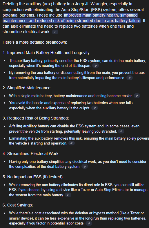

DaveK Posted August 7, 2025 Author Posted August 7, 2025 For those others interested.... I'll offer this up too. Quote
