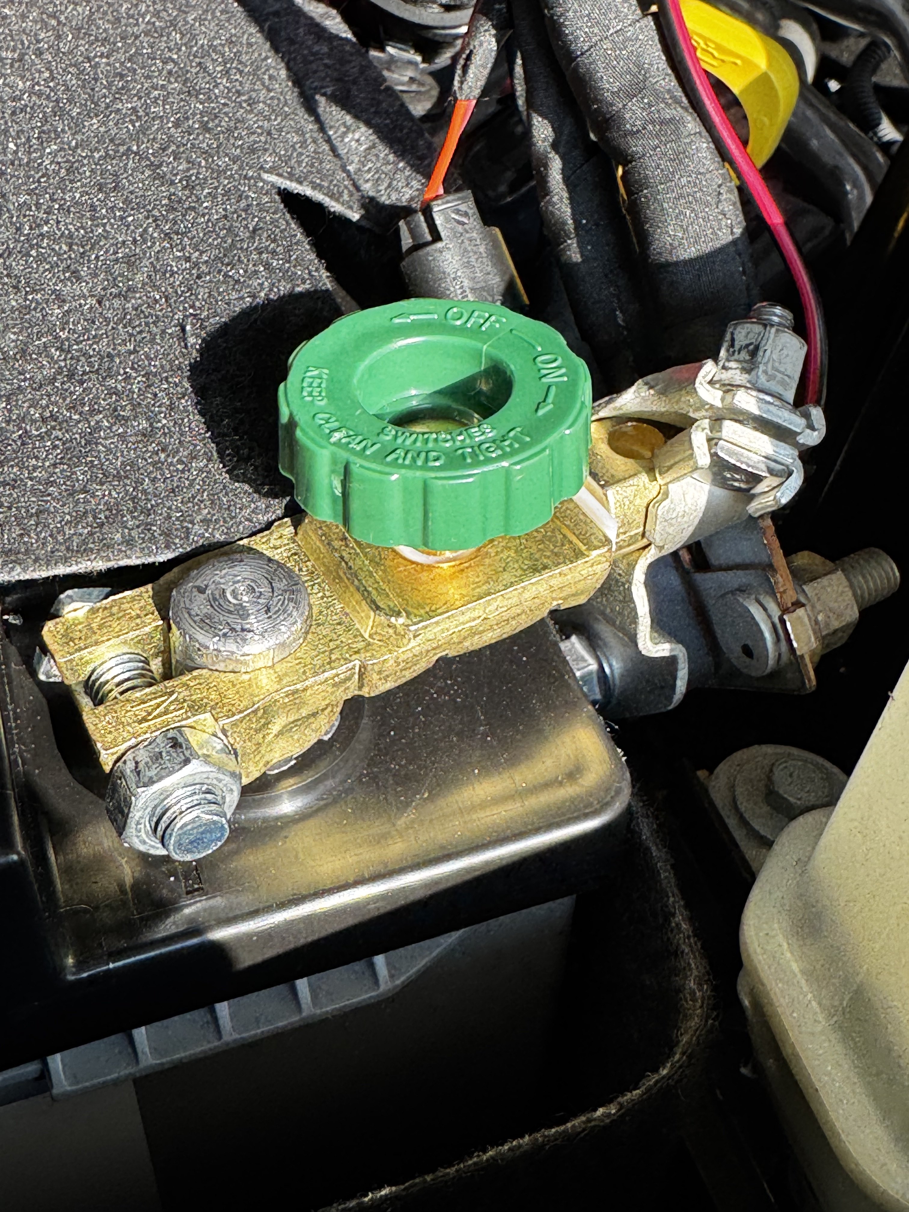

DaveK Posted August 3 Posted August 3 Hooked it up to the negative terminal on the Jeep, put the wires that were on the negative terminal on the end….but when spun didn’t cut power. I didn’t try to start it but it fired up the dash with no issues. Watched a video and even when spun it still drew a bit of power and now thinking that is what was powering the dash and it may not have started. I don’t have that fused part…with the red wire. Better suggestion? Quote

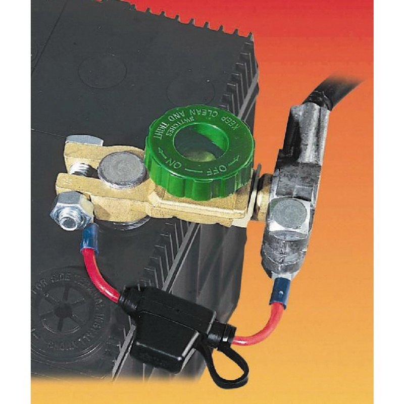

SwampNut Posted August 4 Posted August 4 5 hours ago, DaveK said: but when spun didn’t cut power. Right, it's just a bolt, and to cut power you separate the two pieces. The bolt holds them together. You ALSO need to get rid of that fuse that basically bridges the connection. Quote
Zero Knievel Posted August 4 Posted August 4 Yes. The fuse wire is your problem. Why is it even there? Fuses go on the positive side, and it’s connecting the main negative cable, not an accessory. 🤫 Quote
blackhawkxx Posted August 4 Posted August 4 5 hours ago, SwampNut said: You ALSO need to get rid of that fuse that basically bridges the connection. 10 hours ago, DaveK said: I don’t have that fused part…with the red wire. Quote
DaveK Posted August 4 Author Posted August 4 9 hours ago, blackhawkxx said: Do you have a link to it? https://www.wirthco.com/battery-doctor/battery-disconnect-switches/compact-switches/top-mount-disconnect-switch I hooked it up... and you are supposed to just turn the know to disconnect the 2 metals and that didn't work. So I completely screwed the knob off and the dash was still powered up. Quote

DaveK Posted August 4 Author Posted August 4 6 hours ago, SwampNut said: Right, it's just a bolt, and to cut power you separate the two pieces. The bolt holds them together. Problem is...when I completely unscrewed the knob (completely removed) the dash was still powered up. But, like I said above...I watched a video of a guy who installed it and used a multi meter while unscrewing the knob and the volts slowly went down... and never got to zero. It hung around 6 for about 20 seconds and remained at like 1.5-2. Maybe that was powering my dash... I should have tried starting it. Quote
DaveK Posted August 4 Author Posted August 4 For the hell of the t I popped it back on. Car started right up while the screw (bolt) was out. 1 Quote
Zero Knievel Posted August 4 Posted August 4 Maybe you have a defective one. There's an insulative layer between the two pieces that keeps them apart when there isn't tension being applied. Perhaps yours is a bad one. Do you have another one you can swap out and see if it works normally? Quote
DaveK Posted August 4 Author Posted August 4 32 minutes ago, Zero Knievel said: Maybe you have a defective one. There's an insulative layer between the two pieces that keeps them apart when there isn't tension being applied. Perhaps yours is a bad one. Do you have another one you can swap out and see if it works normally? I thought about that too...it's like a plastic layer. I'll order a new one. On the Jeep there are wires that go from the negative terminal to the positive (including the battery tender wires) so maybe because of how they wire it...there is still a connection. Quote
SwampNut Posted August 4 Posted August 4 I've used a few of those. They all had to be separated. Not a single one cut power properly without separating them. Even worse, what you end up with is unstable voltage/current and arcing that can quickly damage the car. These things are awful, and I've completely stopped using them. I put a real disconnect switch on the RV and will just never use these things again. You can lean on the claim that they SHOULD disconnect without separation, but good luck. Quote

superhawk996 Posted August 5 Posted August 5 I've seen and used this type of device and they worked. My best guess is that this is a POS Chinesium part made by people who have no idea how anything works, the main bit of evidence is the fused wire that defeats the purpose. I know you don't have that installed, and it shouldn't be there unless the disconnect is only being used as an anti-theft device, then it would make sense to have it. I can't tell why yours doesn't work, but I feel like it's probably pointless for you; maybe. Having a quick disconnect makes sense for a vehicle that has a defect or one that gets driven one day per month, or couple months. My understanding is that you'll drive it semi-regularly for a few months, then park it for a few months. If that's correct, leave it connected during the usage time, then just pull the terminal off for the storage time. Quote
