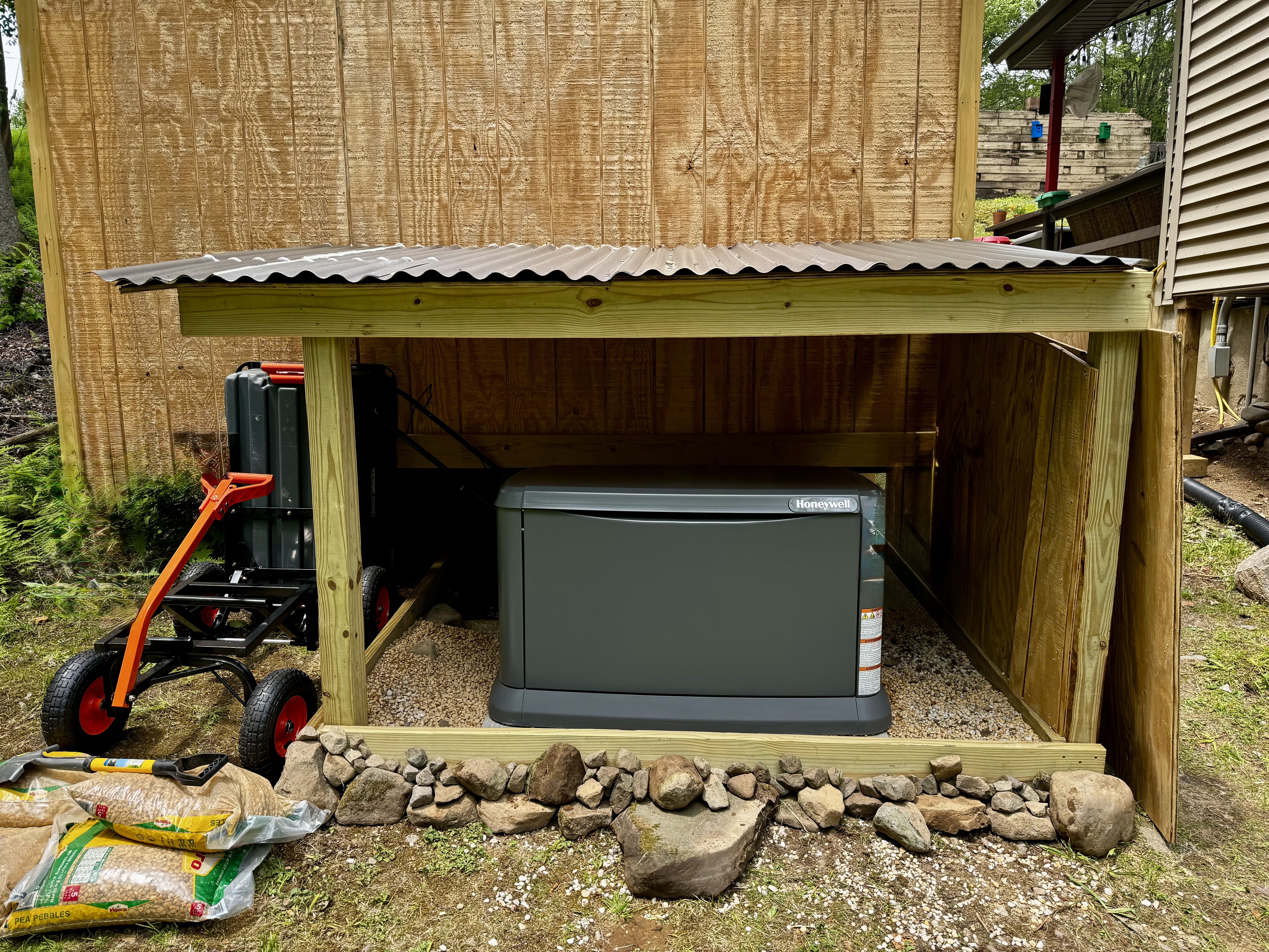

DaveK Posted June 8, 2025 Posted June 8, 2025 I want a front on this shelter I just built. Yes, pricks…I did it all by myself. PS - post spikes are amazing. It’s solid as fuck! But I want to put a front on it that’s removable. Like something on screw hooks and eyelets. Wood is just a bit too heavy - any suggestions? The front piece will be removed maybe 4-5 times a year….leaving the left side open because that is the exhaust side. Right side I left venting up top by sealed the rest with T1-11. Thoughts and suggestions? When it rains sideways the front gets wet and would like to prevent that. Ideas welcome and thanks! Quote

Zero Knievel Posted June 9, 2025 Posted June 9, 2025 I wouldn’t do it. The generator needs air flow to run and exhaust. You’re doing enough sheltering it from sun and rain. The unit is designed for total exposure to the elements. Quote
DaveK Posted June 9, 2025 Author Posted June 9, 2025 (edited) 4 hours ago, Zero Knievel said: I wouldn’t do it. The generator needs air flow to run and exhaust. You’re doing enough sheltering it from sun and rain. The unit is designed for total exposure to the elements. The exhaust is on the left hand side which is completely exposed. Edited June 9, 2025 by DaveK Quote
Zero Knievel Posted June 9, 2025 Posted June 9, 2025 1 hour ago, DaveK said: The exhaust is on the left hand side which is completely exposed. Then why cover the front? If you've blocked the right side and then block the front, you'll be pulling exhaust gases back into the intake. You're doing too much. Quote
DaveK Posted June 9, 2025 Author Posted June 9, 2025 53 minutes ago, Zero Knievel said: Then why cover the front? If you've blocked the right side and then block the front, you'll be pulling exhaust gases back into the intake. You're doing too much. That's a good point, I didn't think of that. The space inside is pretty big and I did leave a 12" vent space on the blocked side but to your point I may be over-doing it at this point. I'll keep that in mind and appreciate you mentioning it. Quote
SwampNut Posted June 9, 2025 Posted June 9, 2025 There's no reason to cover it other than cosmetics. You're also absolutely not going to smother it with a canvas cover as discussed here, which will have plenty of air slots around it. By definition, eye hooks won't let you cover it all and will have air openings. Quote
superhawk996 Posted June 9, 2025 Posted June 9, 2025 6 hours ago, DaveK said: That's a good point, I didn't think of that. The space inside is pretty big and I did leave a 12" vent space on the blocked side but to your point I may be over-doing it at this point. I'll keep that in mind and appreciate you mentioning it. If the exhaust is aimed so that it is directly shooting out the open end what, Zero said is, well, the usual zero value. Recycling the hot cooling air is the only thing I'd be concerned with. If the cooling air exhausts along with the engine exhaust then your fine, otherwise it could be a problem. 1 Quote

fizzy Posted June 10, 2025 Posted June 10, 2025 I would build a simple frame with lightweight wood lattice insert. Note: not the heavy privacy lattice. Use super simple hooks or twist clips to hold it in. Problem with the fabric is if is isn't secured properly all the way around a strong wind will tear it up. Also, roof should have been "pitched" forward a little, but oh well, never mind. 1 Quote
superhawk996 Posted June 11, 2025 Posted June 11, 2025 6 hours ago, DaveK said: I think I have it. In combination with Carlos latching system and this >>> I have my answer. Mesh will breathe but also not let rain through. https://a.co/d/8Z2tQvP Before you do any more, take note of the cooling air outlet direction and whether it's diffused or directed. It can take as little as one obstruction to cause a problem, or it might be fine in a 95% enclosure, as long as the openings are in the right place(s). Quote
DaveK Posted June 11, 2025 Author Posted June 11, 2025 5 hours ago, fizzy said: I would build a simple frame with lightweight wood lattice insert. Note: not the heavy privacy lattice. Use super simple hooks or twist clips to hold it in. Problem with the fabric is if is isn't secured properly all the way around a strong wind will tear it up. Also, roof should have been "pitched" forward a little, but oh well, never mind. It’s pitched. 1 Quote
