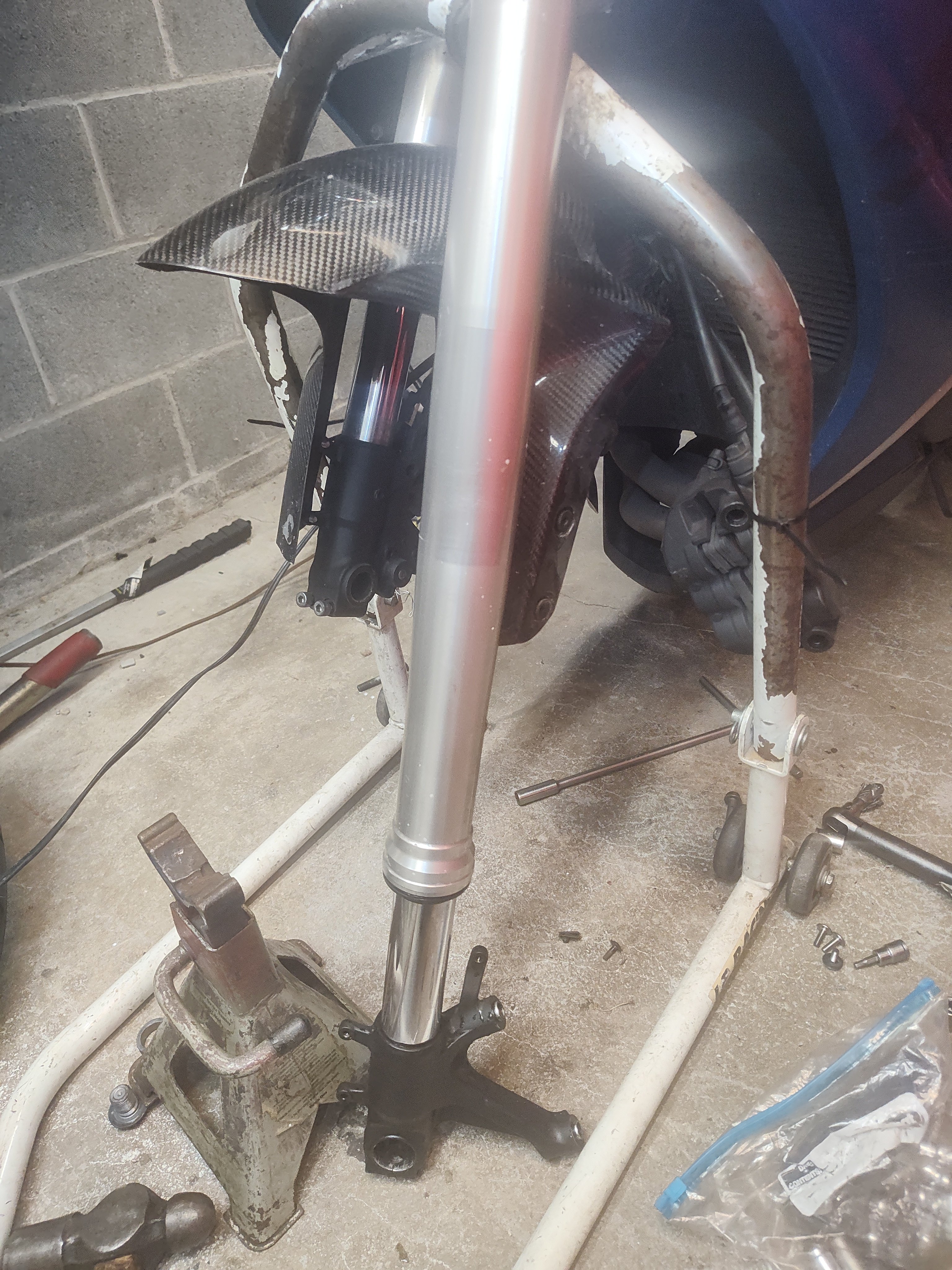

Steering on my viffer has developed "stiff spot" right in the center, of course. Obviously it was time for new bearings, races, etc. 85 K miles.
 Once I was doing that, and everything was off the bike anyway, decided to give fresh rattle can job for calipers, fork bottoms and upper triple tree. Flat automotive Rust Oleum black. Calipers started with, well, brake caliper paint, but it was too shiny for my taste so after first coat I switched back to that flat black.
 Oh, fresh front wheel bearing as well. There was nothing wrong with old ones, preventive maintenance I guess. All Honda OEM parts because All Balls and eBay are incredible chinesium garbage.

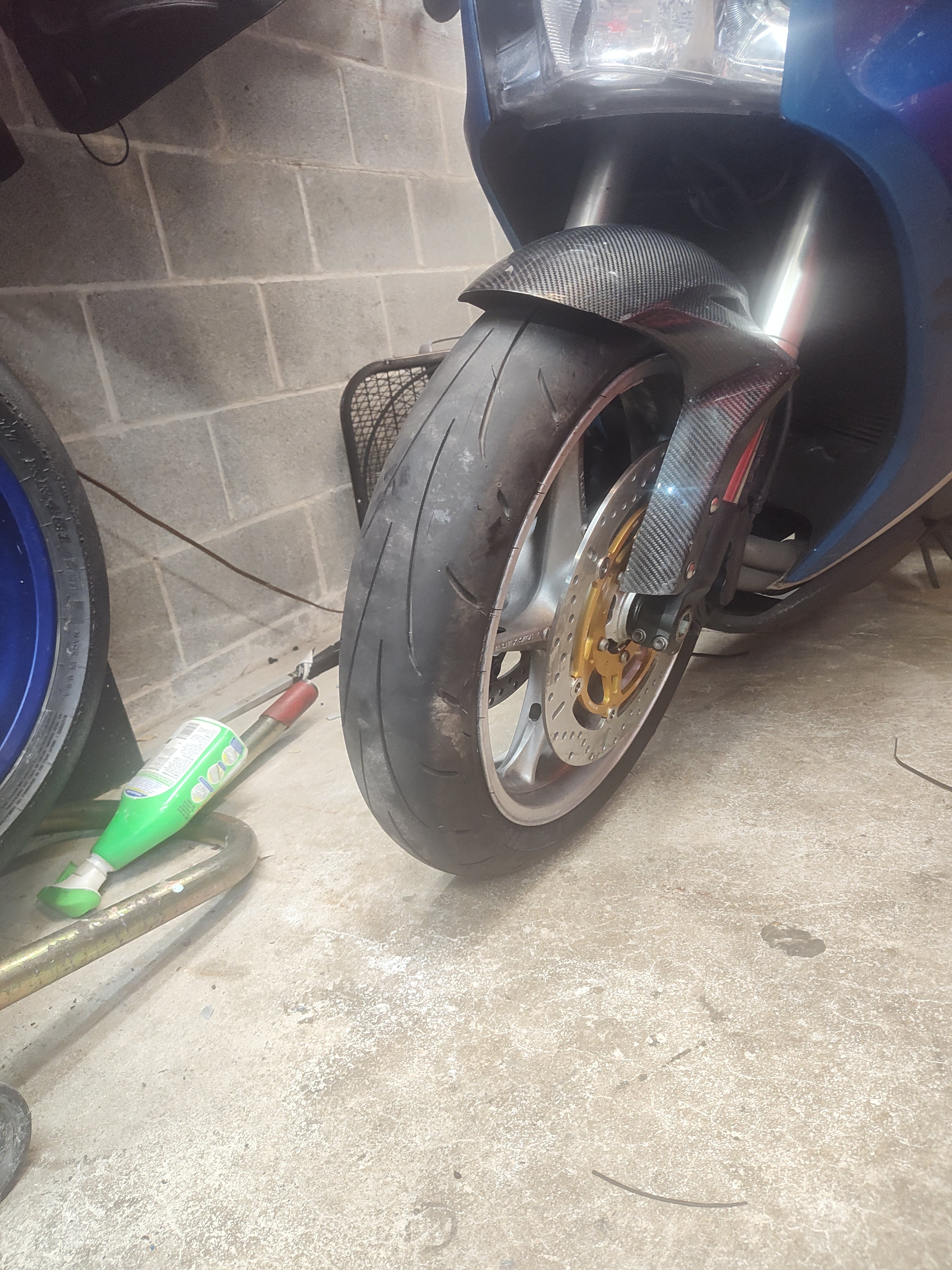

 Also, I tossed Bridgestone RS11, take off with about 1 k miles, that I happened to be laying around my garage.
Safety, obviously, third. OSHA not allowed in my place.

FYI: you mentioned wheels and tires, I have 2 sets of wheels and tires for my BB, due to me having a parts bike. Anyway, I am currently riding on the parts bike wheels and tires, almost 10 year old Metzler Roadtec Z6s with almost no wear. Seem fine, I have pushed them a bit, no issues.  Figured I should use them up before they get any older.
Where did you get that special re-bar alighnment tool ?
Kinda soft to hold the weight?
Don't think I would sit on the bike right now.
Edited by CALCXX
 No clue and/or memory how rebar ended up in my garage. But the bar is still perfectly straight, but I would not sit on the bike. Bike is actually very stable with set up like in the pictures.
 Just to make it clear, I loosen all bolts first except, of course, upper triple tree, with bike still on kick stand.
 I do have couple front stands, but with entire front end off not possible to use them.
