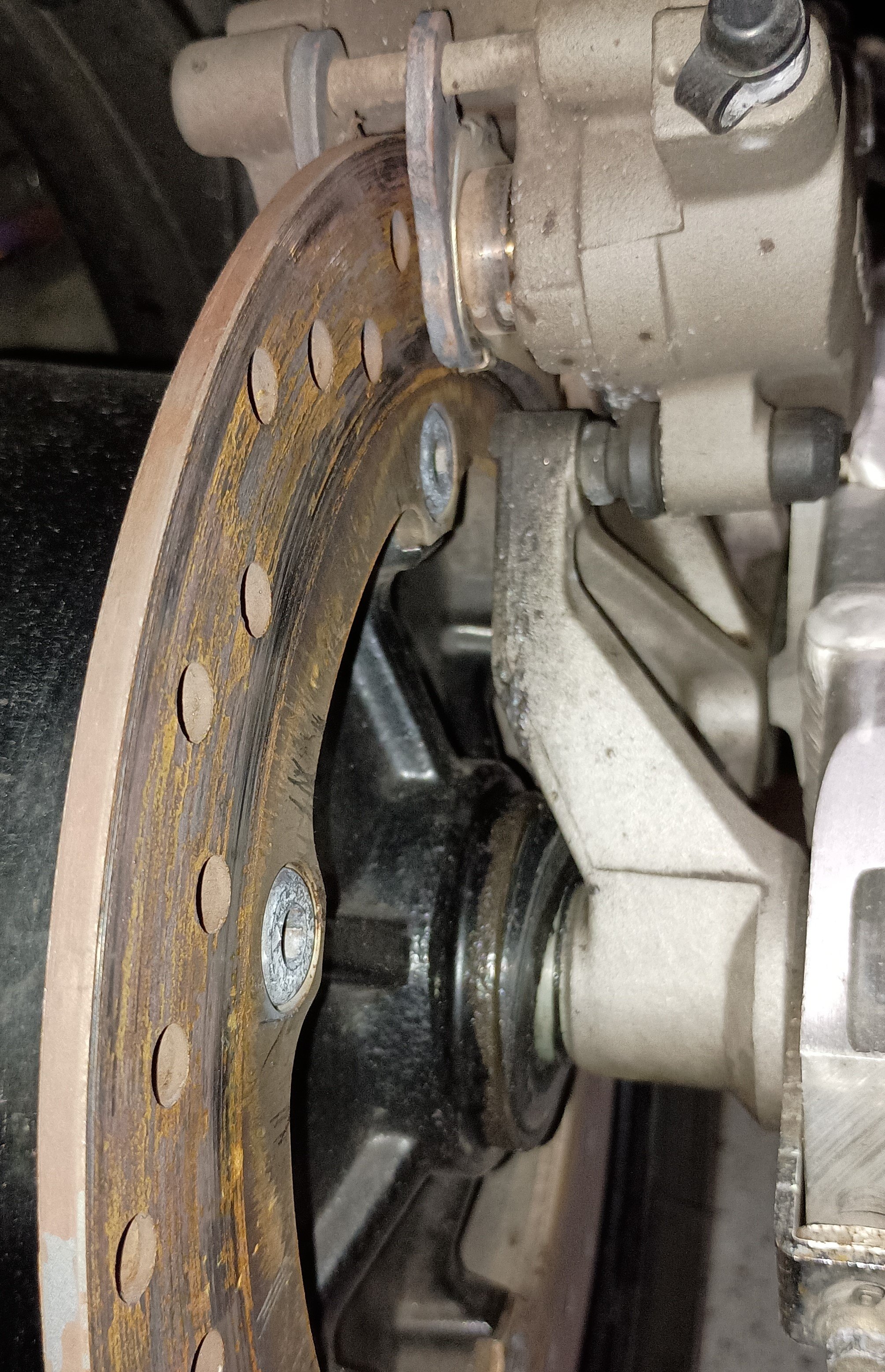

CBRXX Posted September 25 Posted September 25 Since I was blessed with the rear brake failure at NEXXT, looking to source parts. I have the Speigler line kit from the group buy way back in the day as a start Found a chinese brake rotor on ebay for like $60 I thought I would take a chance with, since mine looks pretty f'ed. Any thoughts on sourcing other parts needed, and experience with alternatives. AllBalls has master and caliper rebuild kits that look to save money over the OEM seals, though not for the secondary master. At a minimum I think I need to rebuild the rear caliper since it was so fried, and secondary master as the source of the issue. Probably worth it to plan on the rear master too. I don't think the front master/calipers were impacted, but it's all original. Quote
CALCXX Posted September 25 Posted September 25 (edited) Did you ever get the pistons freed on the OEM caliper? Did you determine the cause of the meltdown? Edited September 25 by CALCXX Quote

CBRXX Posted September 25 Author Posted September 25 Might not be a bad idea for local shop, although I doesn't appear much in the way of tools, more time and patience to do it, and those I am short on. Thanks. Joe. I did already order the chinesium rotor since it was relatively cheap. https://www.ebay.com/itm/267106692734 We'll see what the caliper looks like, I think it will be ok. Will go with the All Balls for what I can get, it does seem like may need OEM for the secondary master, don't think I found that aftermarket. The meltdown was likely caused by the secondary master on the left fork not releasing pressure, causing a slight drag, which caused heat to build. Suspect the constant drag and heat caused a gradually increasing pressure that allowed brake to rapidly wear, perhaps balancing out the pressure. This all happened in the timeframe of 25 miles of backroad, where we never stopped. Touched the brakes at times, but never noticed any drag at speed. As we entered a small town and more brake activity at slow speed, I then noticed the drag. After just a few times braking I then noticed my rear pedal going away. At stop sign I looked down and see the smoking I suspect at that time the pedal faded was when the pads were gone, the pistons fully extended and was metal to metal. By the time I got Joe & Jess' attention and pulled over, it was really smoking. Once stopped, I think the heat and pressure really built up. After 5 minutes on the side of the road discussing options, heard a rather loud pop and a puff of smoke. The heat at the caliper banjo fitting melted the rubber line from the secondary circuit and it burst under the pressure. Even the rear wheel bearing seal was kind of loose and partly falling out of place from the heat in the wheel. I have never really serviced the system properly, so I'm sure there was ample moisture absorbed into the break fluid to boil to steam. They weren't new pads to start, but only had about 4,500 miles on them from when I did pads and wheel bearings. I had just done new tires 2 mo. ago and the pads certainly didn't need changed. Guessing when I did the tires and pushed the calipers back, it stirred up crap in the lines. Had it out for a few very short local rides around town after doing the tires and nothing odd. Quote
CALCXX Posted September 25 Posted September 25 Yeah, that piston is really extended. friction pad gone. Hot no doubt. Quote
