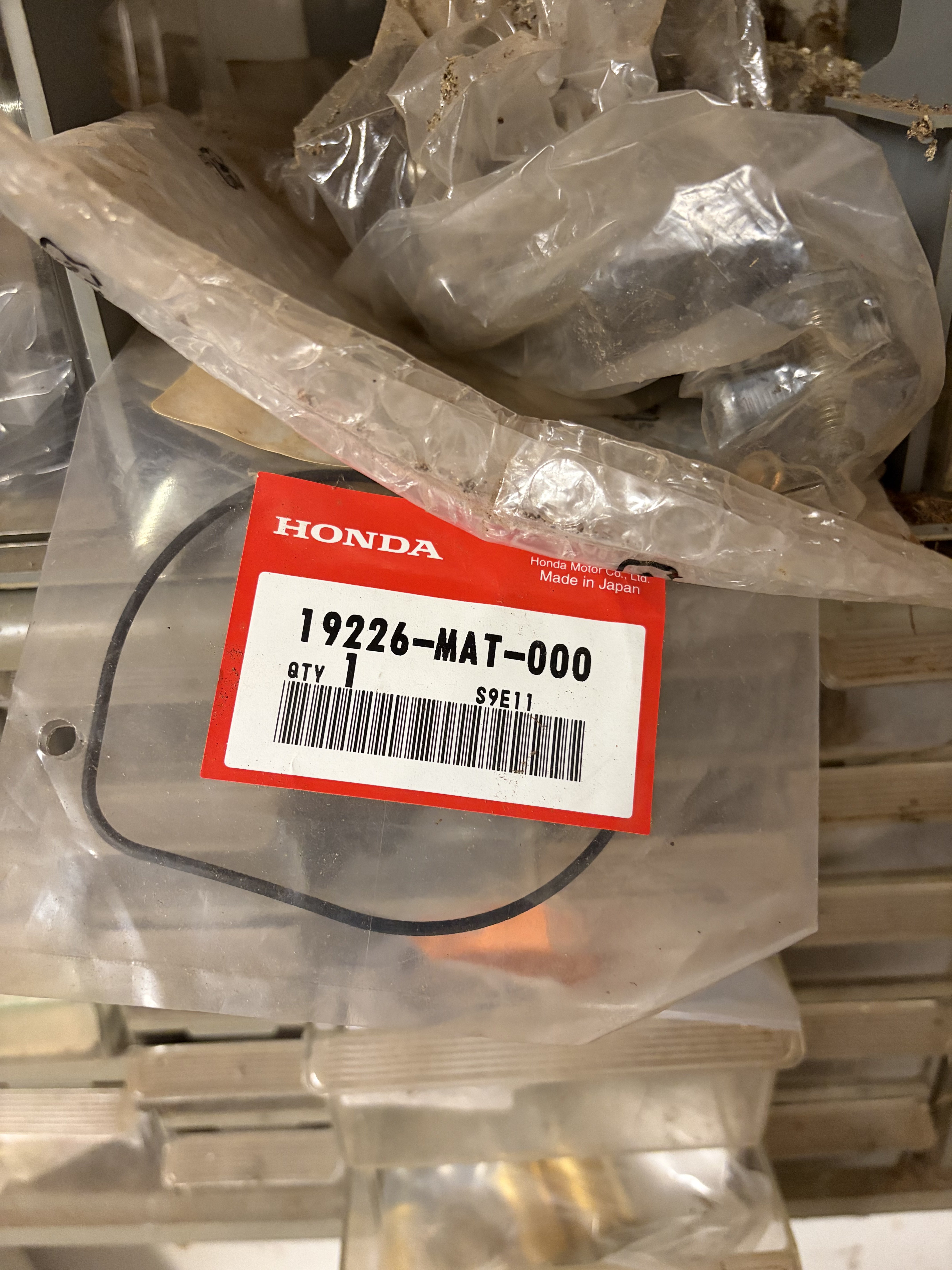

RXX Posted August 12 Author Posted August 12 Got as far as filling with anti freeze and let it run up to temp a few times only to find a weeping water pump gasket. Not from the weep hole. Ordered new gaskets. This will set me back a few days. I hate having to drain a gallon of brand-new no boil but it is what it is. I have not done a R/R on one of these before. Looks fairly straightforward by the shop manual. Any tricks or pitfalls? BTW, Mike……. The plugs I replaced were NGK. Not the exact model. Quote

RXX Posted August 13 Author Posted August 13 So I ordered gaskets & seals to be expedited and got a back ordered - no ETA on the gasket. Fuck me. Started thinking about taking the street triple but that is such an unsatisfactory option I had to sleep on it. Then, during a drwam, I envisioned myself as a crusty old fart that hoards shit. This morning, I scrounged through the barn and found my “Rockmeupto125” starter kit and VOILA!! Thanks, Joe. You are an inspiration. When (if) I grow up I want to be just like you!! 1 Quote

RXX Posted August 13 Author Posted August 13 44 minutes ago, Zero Knievel said: That's what...a couple of years? Man I don’t know. Come to think of it that gasket may have come with your bike. I just don’t remember. 130000 miles on a water pump ain’t too shabby. Quote
Zero Knievel Posted August 14 Posted August 14 18 hours ago, RXX said: Man I don’t know. Come to think of it that gasket may have come with your bike. I just don’t remember. 130000 miles on a water pump ain’t too shabby. Had to be Joe. I replaced the thermostat and changed over to the water-free stuff, but I didn't touch the pump. Quote

The Krypt Keeper Posted August 15 Posted August 15 On 8/13/2026 at 10:51 AM, RXX said: So I ordered gaskets & seals to be expedited and got a back ordered - no ETA on the gasket. Fuck me. Started thinking about taking the street triple but that is such an unsatisfactory option I had to sleep on it. Then, during a drwam, I envisioned myself as a crusty old fart that hoards shit. This morning, I scrounged through the barn and found my “Rockmeupto125” starter kit and VOILA!! Thanks, Joe. You are an inspiration. When (if) I grow up I want to be just like you!! going to be doing a a bunch of crap this winter on my XX and finding a lot of stuff on back order with no date in sight. Quote
poida Posted August 15 Posted August 15 i know you have one now but i have been buying parts from webike japan.have had a good exchange rate so stocked up on consumables and other parts i needed.delivery usually within 2 weeks to australia. https://japan.webike.net/ps/19226-mat-000/9000/#!search&p.k=19226-mat-000&p.c=9000&p.m=312 Quote
