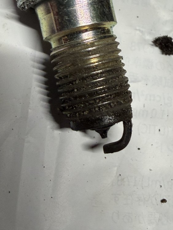

Zero Knievel Posted August 5 Posted August 5 12 hours ago, SwampNut said: It also doesn't say to not put them up your ass. If it’s a choice between using antiseize so you DON’T have a stuck plug that could break off in the effort to remove it or going without and taking that risk…you need assurance that the plug you are using DOES NOT need it and WILL NOT seize. You’re being pedantic about something I’ve never seen on the packaging (and there is no insert in the box). Only warning was to not adjust the gap as it comes pre gapped. If it was a critical factor, it should be on the packaging. Hence, at worst it may affect performance, but it won’t break the motor. Quote
rockmeupto125 Posted August 5 Posted August 5 7 hours ago, CALCXX said: I stopped putting anti-seize on spark plug threads in the 80's after the troubles with my new SC500 Yamaha. Not good. In the early days of anti-seize, it was aluminum base. Not a copper mixture of today. I used an ohm-meter back then and read the resistance of a blob of anti-seize. Not good. so, I stopped. Can't speak for todays anti seize with copper added. ???? Check with ohm-meter when in doubt. Best be zero resistance. I don't use antiseize on the plug seat, where I expect reliable metal to metal contact. 1 Quote
RXX Posted August 5 Author Posted August 5 4 hours ago, Zero Knievel said: If it’s a choice between using antiseize so you DON’T have a stuck plug that could break off in the effort to remove it or going without and taking that risk…you need assurance that the plug you are using DOES NOT need it and WILL NOT seize. You’re being pedantic about something I’ve never seen on the packaging (and there is no insert in the box). Only warning was to not adjust the gap as it comes pre gapped. If it was a critical factor, it should be on the packaging. Hence, at worst it may affect performance, but it won’t break the motor. OK, so there was no insert in the carton or the box. The only instructions were to not gap with feeler (or maybe that it does not need gapping, I am not fluent in pictures) and to not use in airplanes or powered gliders (I am fluent enough to grok that) You are right. But my question is, now that you have read an official stance from NGK re: anti-seize, are you going to continue to use it on NGK plugs? If so, why? Quote
Zero Knievel Posted August 5 Posted August 5 47 minutes ago, RXX said: OK, so there was no insert in the carton or the box. The only instructions were to not gap with feeler (or maybe that it does not need gapping, I am not fluent in pictures) and to not use in airplanes or powered gliders (I am fluent enough to grok that) You are right. But my question is, now that you have read an official stance from NGK re: anti-seize, are you going to continue to use it on NGK plugs? If so, why? I have no issue using NGKs, but right now, my RS doesn't use platinum or iridium plugs, so it's a non-issue. I used anti-seize on the XX every time and ran platinum/iridium the whole time. Never had an issue. Again, if NOT using anti-seize is "official" and "important" it should/would be on the product. There is no valid reason for NGK to put this on their website but leave it off the actual product. Who visits a website to research a purchase AFTER they have the item. You only do that when you have questions the included instructions don't answer. I get my NGKs for the truck today. It will be interesting if there are any indications in this matter. That they were using this coating since 2001 but never marked it on the packaging, one has to wonder how "critical" an issue this is to debate over. Quote
SwampNut Posted August 5 Posted August 5 7 hours ago, Zero Knievel said: Hence, at worst it may affect performance, but it won’t break the motor. A lot of people have stripped alloy threads by using lube and then over-tightening since it's 20% easier. On top of the problem that Cal pointed out, which I also ran into. You've built a church on top of a bunch of assumptions. Do not eat the battery door. Quote

Zero Knievel Posted August 6 Posted August 6 Phillip, the plugs you pulled, what make are they? I normally go with Bosch, but sometimes I go NGK. I know the RS specified NGK, but I likely had Bosch in the XX. Quote

Zero Knievel Posted August 6 Posted August 6 On 8/5/2026 at 12:09 PM, SwampNut said: A lot of people have stripped alloy threads by using lube and then over-tightening since it's 20% easier. On top of the problem that Cal pointed out, which I also ran into. You've built a church on top of a bunch of assumptions. Do not eat the battery door. Well, for what it's worth, I got my NGK iridium plugs. Looked over all of it. Nothing indicating anything pro or con about anti-seize. If it was important, you think they would put it somewhere in or on the packaging. The do warn you not to overtighten, adjust gap or use in aircraft/gliders. Quote
RXX Posted August 6 Author Posted August 6 5 hours ago, Zero Knievel said: Well, for what it's worth, I got my NGK iridium plugs. Looked over all of it. Nothing indicating anything pro or con about anti-seize. If it was important, you think they would put it somewhere in or on the packaging. The do warn you not to overtighten, adjust gap or use in aircraft/gliders. So are you going to apply aftermarket anti-seize? Quote
Zero Knievel Posted August 7 Posted August 7 10 hours ago, RXX said: So are you going to apply aftermarket anti-seize? I decline to answer because I want Carlos to squirm in the uncertainty. Quote
Zero Knievel Posted August 7 Posted August 7 This is a freaking rabbit hole. No manufacturer of plugs puts warnings on their product. Anti-seize products say they are for spark plugs (no warning to not use with certain plugs). So, you have to check with the plug manufacturer AND research the year, make and model of the motor to see IF you can/should use it…you can’t trust the packaging (or inserts) to warn you. Fortunately, I’ve never had an issue, so I won’t lose sleep over this, but I will research before going forward with future plug changes. Quote

superhawk996 Posted August 9 Posted August 9 On 8/4/2026 at 9:36 PM, CALCXX said: In the early days of anti-seize, it was aluminum base. Not a copper mixture of today. I think the common silver anti-seize is zinc, not aluminum, tho aluminum might also exist. The copper stuff is typically used in high temp stuff like exhaust parts. I don't know if there's an "official" recommendation about this, but I'd avoid using copper on aluminum parts because I fear the combination of those metals would lead to a bad reaction. The only time I've seen the combination was on my Porsche's transmission bolts, the heads snapped off several of them trying to remove them. My moderately educated $.02 on this: Zinc is a sacrificial metal compared to almost every other metal so it protects the metals. Copper is very noble so your metal parts become the sacrificial anode, particularly aluminum which has a low nobility. Quote
SwampNut Posted August 9 Posted August 9 4 minutes ago, superhawk996 said: My moderately educated $.02 on this: Zinc is a sacrificial metal compared to almost every other metal so it protects the metals. Copper is very noble so your metal parts become the sacrificial anode, particularly aluminum which has a low nobility. Yeah, this, also see the hydrofoil discussion where your comments would be useful. Quote
