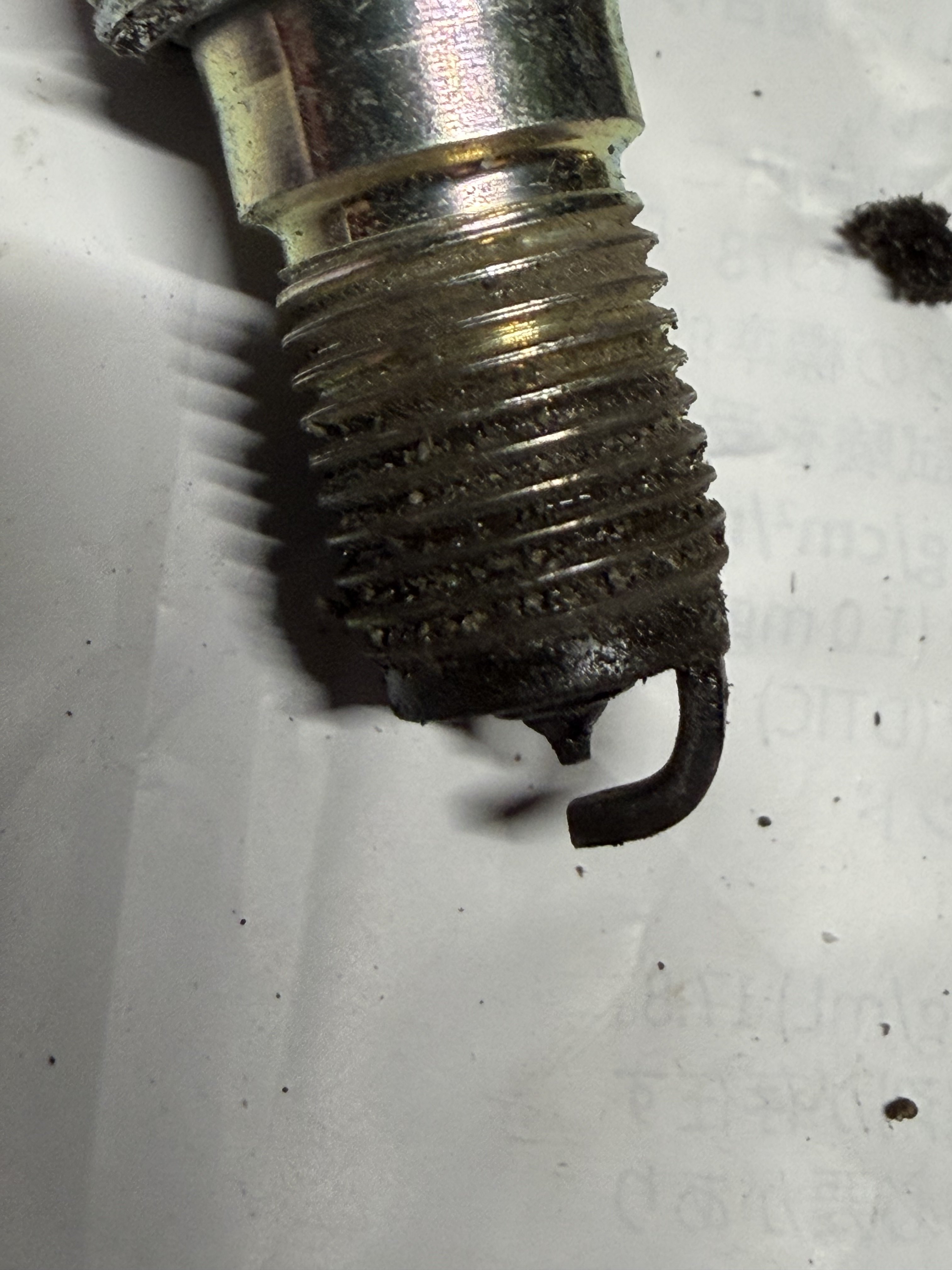

RXX Posted August 4 Author Posted August 4 I got as far as #1 tonight. I am pretty sure this is my first plug replacement since I’ve had this bike, so at least 20,000 miles and many years. as you can see there is gunk on the threads. I am assuming from plug thread goo. Should I use the stuff when I am re-installing or leave it be? I can’t clean what’s down there already? What does this plug tell you savants? Quote
Zero Knievel Posted August 4 Posted August 4 It would have been anti-seize. I’d never insert plugs without it. Quote
SwampNut Posted August 4 Posted August 4 OMG. Modern plugs, particularly NGK, have a coating that prevents both corrosion and seizing. They specifically say not to use any lubes since they can themselves cause a problem. Jeezus. "Modern" meaning like 30 years probably. https://ngksparkplugs.com/en/resources/5-things-you-should-know-about-spark-plugs Quote
RXX Posted August 4 Author Posted August 4 53 minutes ago, SwampNut said: OMG. Modern plugs, particularly NGK, have a coating that prevents both corrosion and seizing. They specifically say not to use any lubes since they can themselves cause a problem. Jeezus. "Modern" meaning like 30 years probably. https://ngksparkplugs.com/en/resources/5-things-you-should-know-about-spark-plugs well, there you go. I am literally in the parts parking lot about to go in and get some. You saved me a buck or two. Now I will just obsess about all the shit left behind in the threads. Now I will just obsess about the torque being incorrect. Oh, never mind. There is no fucking way I can torque the plugs in those cramped quarters. Quote
RXX Posted August 4 Author Posted August 4 4 hours ago, Zero Knievel said: It would have been anti-seize. I’d never insert plugs without it. Given the link Carlos supplied, are you going to re-think your position? Quote
SwampNut Posted August 4 Posted August 4 14 minutes ago, RXX said: Given the link Carlos supplied, are you going to re-think your position? Are you new here? 18 minutes ago, RXX said: Now I will just obsess about all the shit left behind in the threads. Yeah, that sucks, and I don't know what's safe to clean that shit out. Maybe @superhawk996 will have ideas? Quote
Zero Knievel Posted August 4 Posted August 4 4 minutes ago, RXX said: Given the link Carlos supplied, are you going to re-think your position? Perhaps, but it was NEVER on the packaging that I can recall...or it was in such small print you'd never see it. Indeed, I just bought a replacement set for the truck and this was the FIRST TIME I EVER saw anything about not needing anti-seize on the plug. It will be interesting if they come with any such statement on the packaging. 11 minutes ago, RXX said: Now I will just obsess about all the shit left behind in the threads. Now I will just obsess about the torque being incorrect. Oh, never mind. There is no fucking way I can torque the plugs in those cramped quarters. Don't worry about the "shit." If the motor hasn't been fucked up by now, it won't be an issue. As far as insertion, I used the socket and extension to get the plug into the hole. Slowly turn it left until you hear the threads skip then slowly turn right to hand tighten it into the motor. I don't think I ever used a torque wrench as mildly-snug with a socket wrench always did the job. If you have enough extensions or long enough ones, you could get the torque wrench on and check if you really want to. Quote

Zero Knievel Posted August 4 Posted August 4 15 hours ago, RXX said: I got as far as #1 tonight. I am pretty sure this is my first plug replacement since I’ve had this bike, so at least 20,000 miles and many years. as you can see there is gunk on the threads. I am assuming from plug thread goo. Should I use the stuff when I am re-installing or leave it be? I can’t clean what’s down there already? What does this plug tell you savants? I wouldn't blame that on anti-seize. First, I put it on the entire threads. It's much cleaner at the base. That looks like a rich running motor, which I believe is normal for the XX on the low end. You likely have the old plugs I saved from the last change (in case there was an emergency need to replace a plug). How does this compare to those...if you still have them? Quote

The Krypt Keeper Posted August 5 Posted August 5 (edited) Brake cleaner with straw for threads, give a few minutes to evaporate, air nozzle with long reach end to force debris to evacuate from cylinder Dont stick spark plug or air nozzle in ass according to Carlos. Brake cleaner probably has this warning ⚠️ Edited August 5 by The Krypt Keeper 1 1 Quote
CALCXX Posted August 5 Posted August 5 I stopped putting anti-seize on spark plug threads in the 80's after the troubles with my new SC500 Yamaha. Not good. In the early days of anti-seize, it was aluminum base. Not a copper mixture of today. I used an ohm-meter back then and read the resistance of a blob of anti-seize. Not good. so, I stopped. Can't speak for todays anti seize with copper added. ???? Check with ohm-meter when in doubt. Best be zero resistance. Quote
