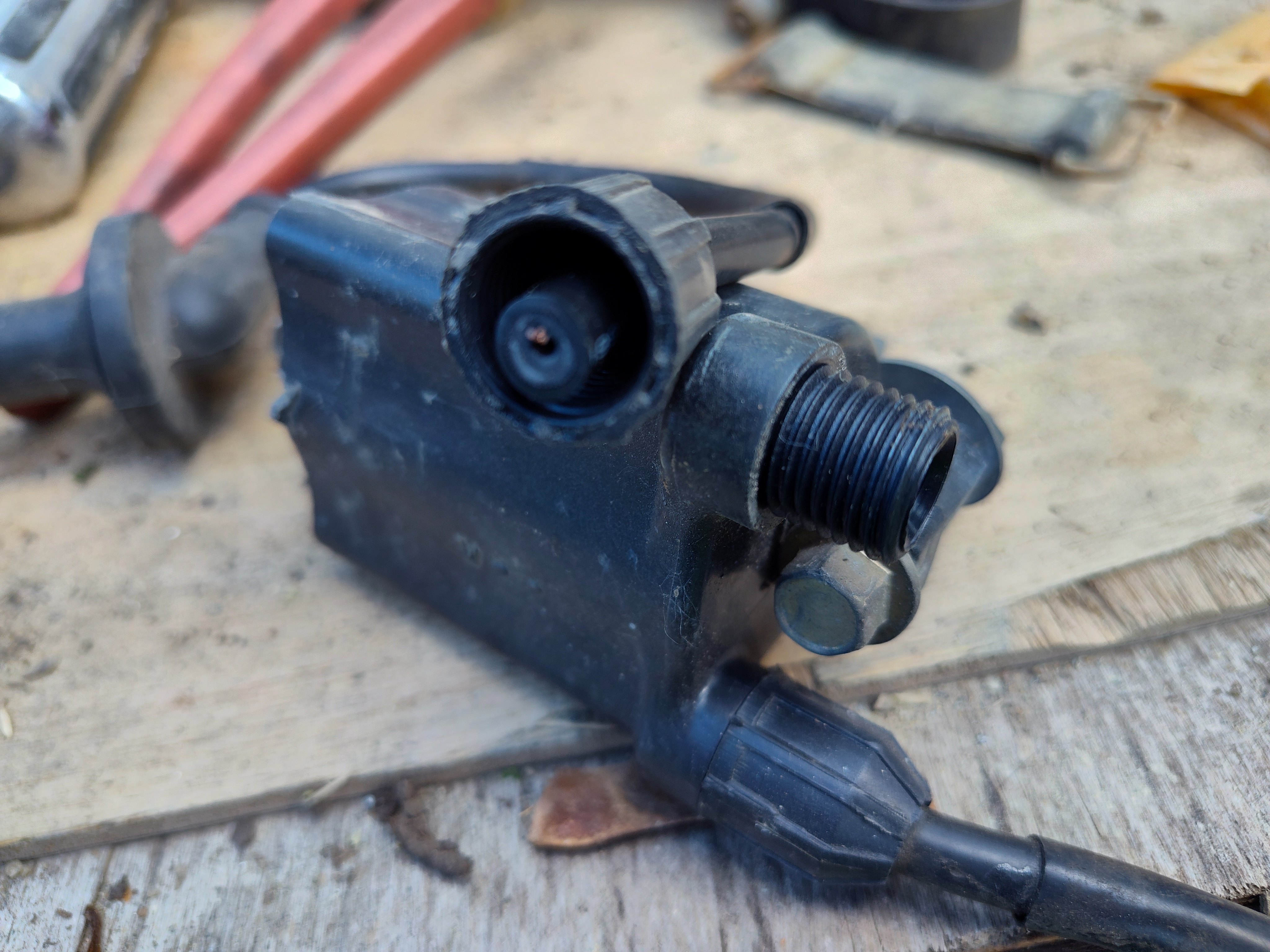

Oh, the spark plug leads unscrew from the coils.
My Honda coils of the past, removed the wire from the coil, snipped a 1/4in to start anew.
Reattach. Just like new. Like Joe said, unless physically damaged, coils rarely fail.
