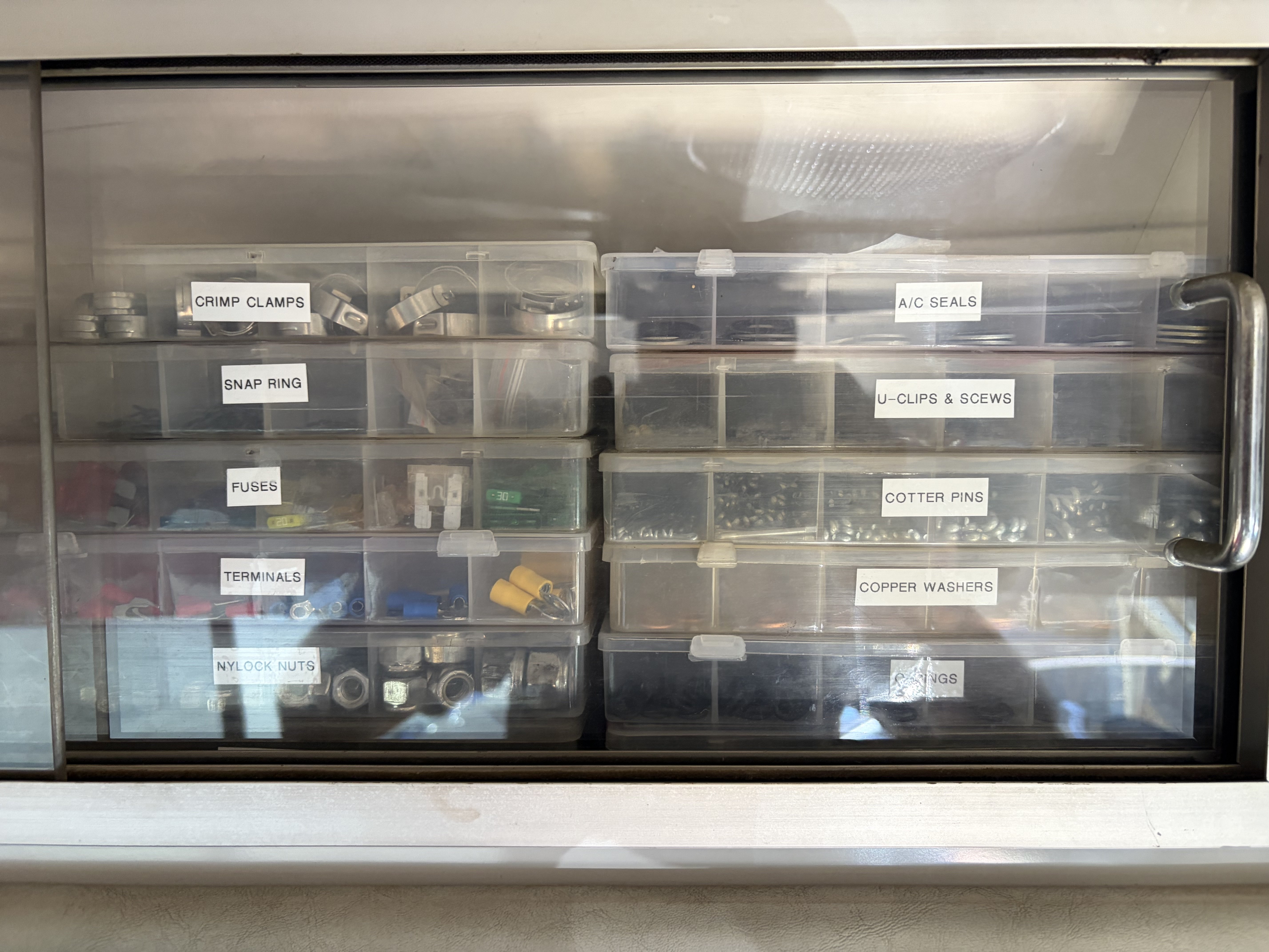

Posted (edited)
I lucked out and found an empty box in my stash that matched the size of my other boxes, just had to make a divider to keep the sizes segregated.  This is why I don't throw away anything.  I have a compartment in the ambulance with a dozen small clear plastic boxes for small stuff; fuses, cotter pins, springs, crush washers, etc.  And now one for these clamps.  The boxes vary slightly in design, but they're the same size so they stack well.
Edited by superhawk996
I couldn’t post the photo from my computer, but for some reason I can from my phone.  This is why a functional box is important to me, a matching sized one is ideal.
  • Like 1
Shit, you went all in.  What do all the different tools do?
My question exactly!
