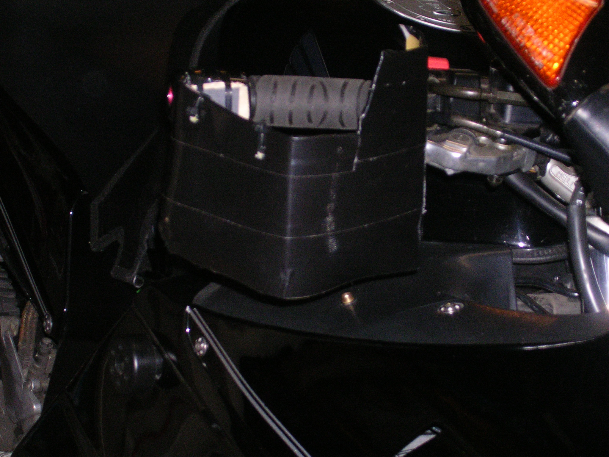

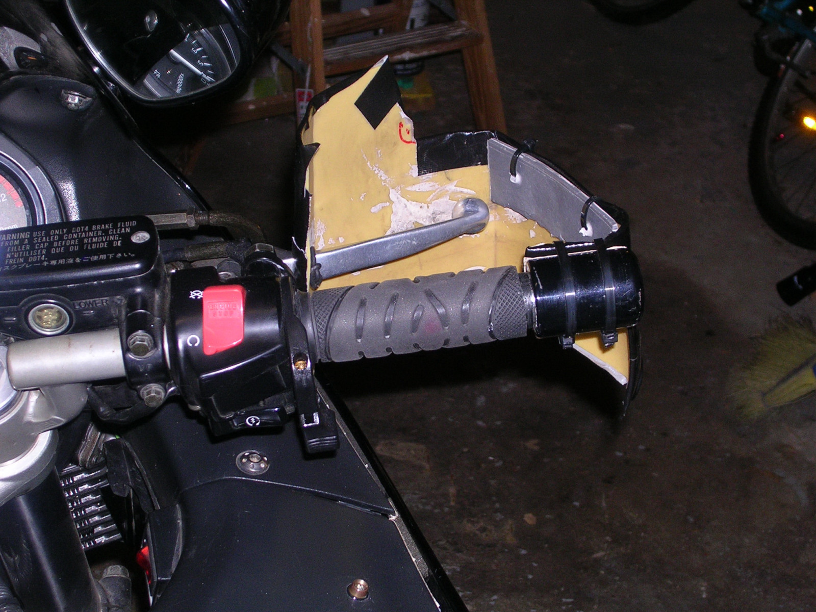

I needed something as a temporary wind break, but it turns out they work fairly well. I saw a couple of members lament not having anything for wind protection.
I used a couple of tupperware plastic tubs for materials, and obviously covered them with tape. The fairing for the throttle side is reinforced with a strip of heavy plastic to keep the wind at speeds over 65mph from pushing the fairing into the brake lever and activating the brake light. I used cardboard as a pattern to get the shape and fit. The cut out is to clear the mirror with the handlebars at lock. Note the twisted up 'O' ring wrapped around the lever near the pivot point of the lever. This keeps the wind from collapsing the fairing in toward your hand. I added the mods (o-ring & grey plastic reinforcement) after the first run with it on the bike.
This did the trick. Use coarse steel wool to rough up the surface of the plastic before applying the tape. You can probably use spray paint, but I didn't test it out- I'm not sure it will hold. It's not a problem on the clutch side- just tape or o-ring on the pivot point side of the lever.
Click to view attachment

what is the small orange light in the right side fairing for?

the orange light is my front turn signal, folded back
If the hand guard shown by Wario can clamp onto the bar end weight- it'd work
there's no space on the helibar for the clamp/ support otherwise

I think he is referring to what appears to be an orange-ish LED or pilot light sticking up out of the gas tank surround.

Would that be the kill switch in the first pic?

yes - you're looking at the throttle side.
