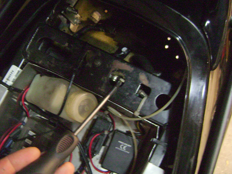

If the cable is still attached you will get a small space when the cowl is pulled back.
the screw driver indicates the part on the seat latch mechanism, it will move pretty easily.
Obviously mine has an after market tail. Hope this helps I can't remeber what the standard underseat looks like but the cable has very little free movement. Don't forget the electric cables.

Problem solved. The bolt that holds the cable/latch assembly to the cross bar was loose, allowing the cable to catch/snag on the opening where Kiwimack has the screwdriver in the picture. Tightened it up and hopefully won't have anymore issues.
