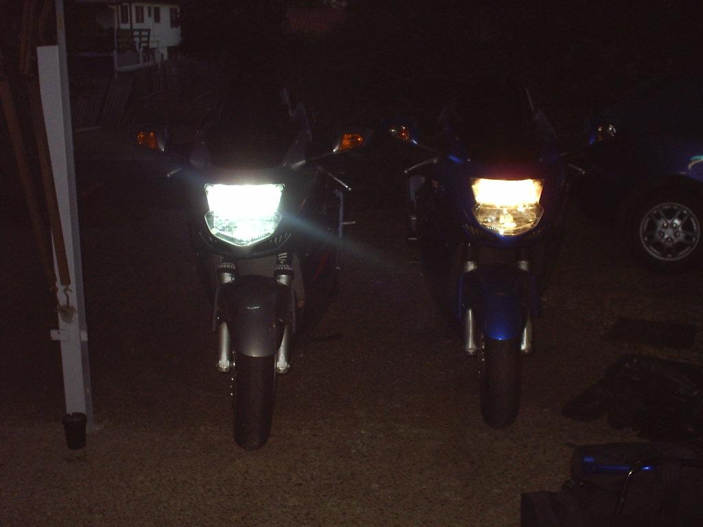

HID lighting is worth every penny spent. And the price for a H7 kit (include two bulbs/ballasts) is now $65 to your door.
...soooo, here you go, for the non-believers, if there are any of you left that is, eusa_shifty.gif
Stock low beam H7:
HID 4300K low beam H7:

Click to view attachmentHere's another HID light comparison pic on low beam.

VERY impressed with this HID kit. EASY installation and nice WHITE light. I have a Super White zenon bulb for my HB that is VERY white compared to the stock bulbs and this HID light is a lot whiter than it is. I pretty much don't need the HB anymore. It fills in a spot on the ground just in front of the bike.
Best $35 I've spent in a long time. Now I need to get a set for my wife's FZR 1000.
Thanks Jason!!
$80 to Norway shipped and taxes. 1/2 price of what the sell in the stores.
