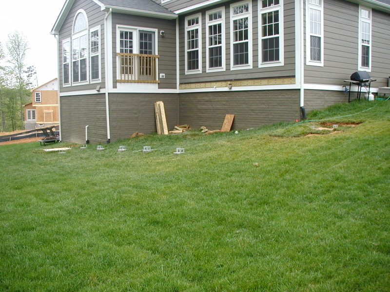

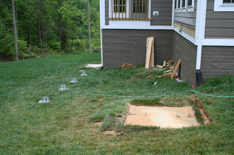

Ledger Board, Footings and Landing Pads complete

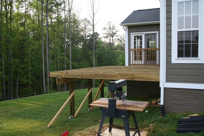

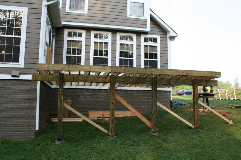

Framing complete

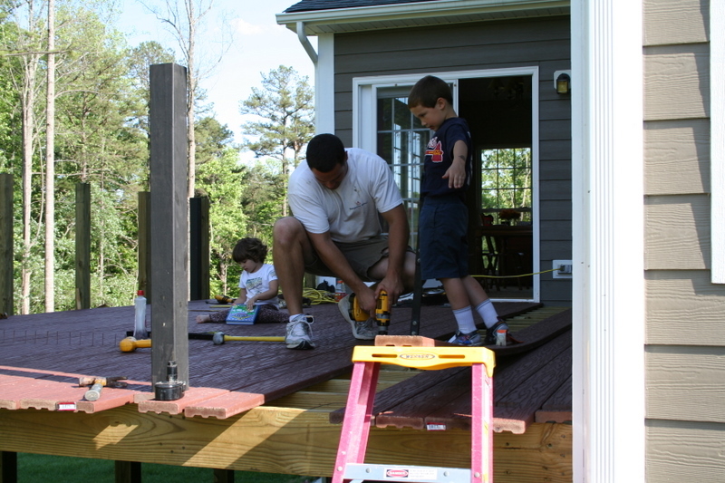

Deck planks being installed, my son using the deck board pusher.

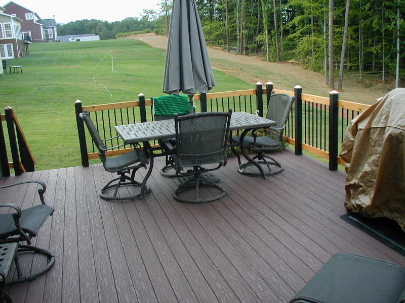

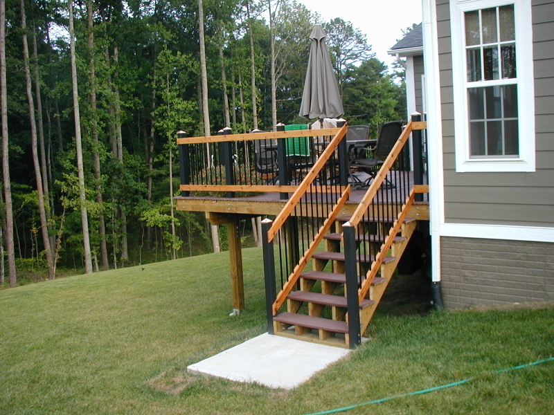

Finished

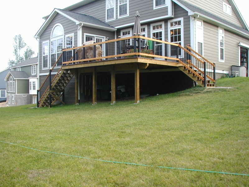

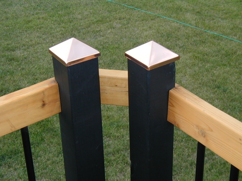

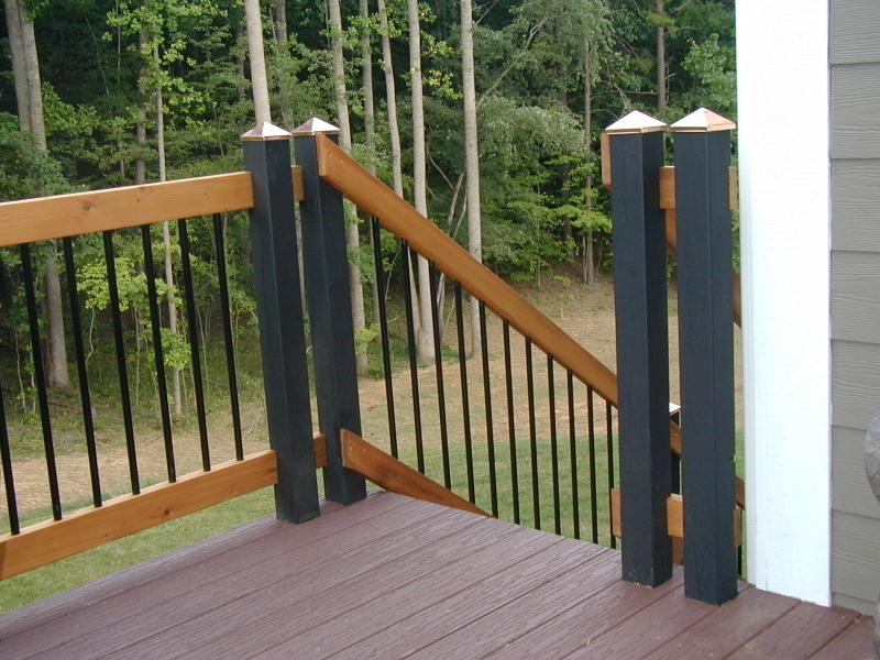

I put double posts on the corners as a theme for the deck

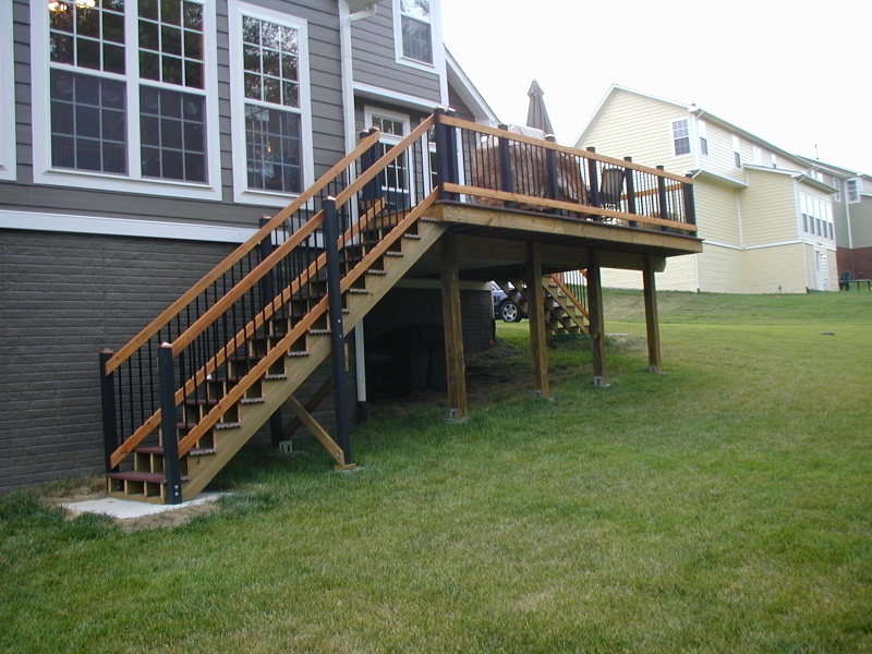

This deck has two stairs, which were rather time consuming to create.
I added panels under the deck create a dry storage space. They're installed to be hidden from most views.

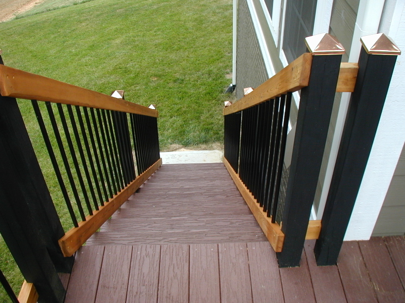

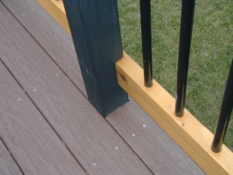

The railing was very labor intensive, mainly because of these lap joints where the railing attaches to the posts.
