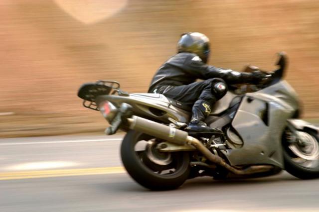

This is likely to affect ground clearance as well, isn't it?

Yes
[img]
http://www.cbr1100xx.org/forums/gallery/11..._179_413297.jpg[/img]
And without the spring upgrade is more likely to compress even more. Look at Joe's lower fairing and I've banged the header a couple times which is scary when you feel the wheels un-weighting.
