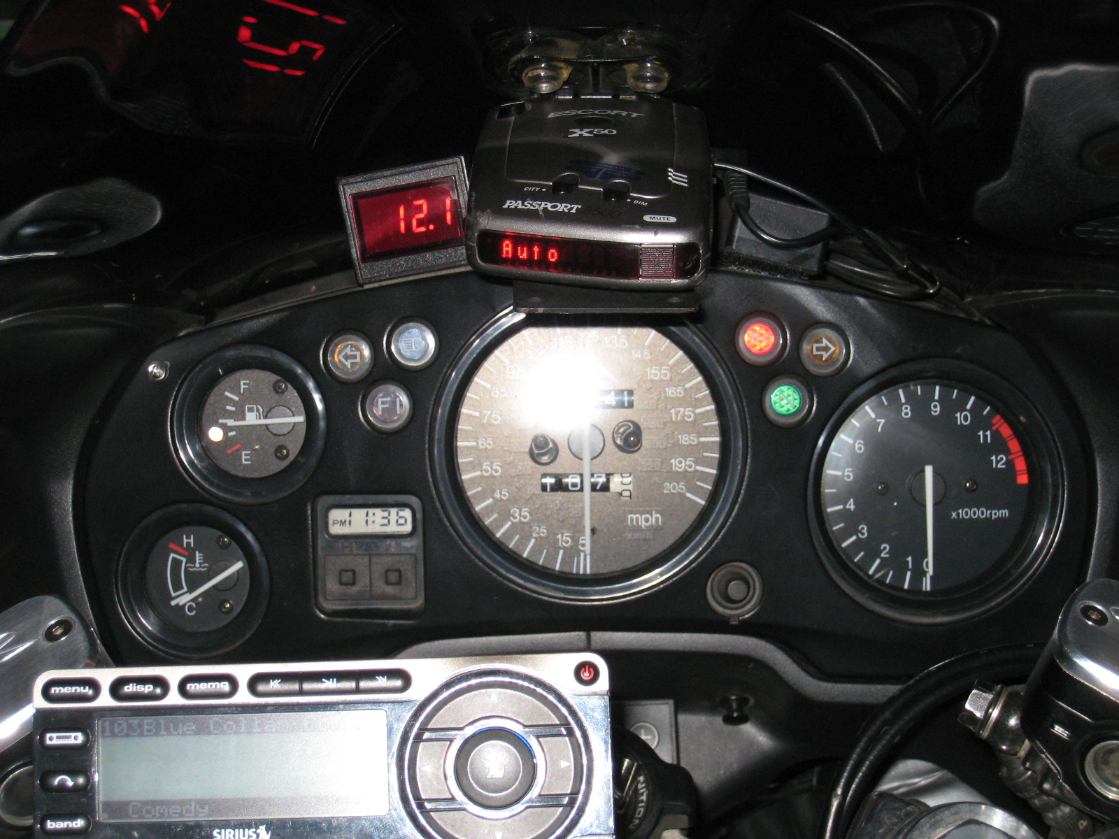

BigMig Posted August 25, 2009 Posted August 25, 2009 When SlowRide and Brett helped me install HIDs, we had a lot of the tupperware off - so Steph suggested we run the wires up and mount the Datel between the top of the dashboard and the tinted windscreen. It's nice there because it's always shaded - so it can be easily read in open sunlight. Steph recommended (as well as supplied) velcro ands it's held nicely for 1+ year. Thanks again Steph! Can post photos later in the week. You get the idea Mike Quote
Zero Knievel Posted August 25, 2009 Posted August 25, 2009 When SlowRide and Brett helped me install HIDs, we had a lot of the tupperware off - so Steph suggested we run the wires up and mount the Datel between the top of the dashboard and the tinted windscreen. It's nice there because it's always shaded - so it can be easily read in open sunlight. Steph recommended (as well as supplied) velcro ands it's held nicely for 1+ year. Especially if you can rig a nice little cover so it blends with the dash. Quote
ActionStarCBRxx Posted September 13, 2009 Author Posted September 13, 2009 Found the mounting spot... how do I hook it up? I am running the ground to the front metal frame supports to the nose fairing. (right by where the horn mounts) But on the positive terminal... I am not sure where to go. If I go straight to the battery, then the meter will always be on? That will be a continous pull on the battery. Quote
TuffguyF4i Posted September 14, 2009 Posted September 14, 2009 Found the mounting spot... how do I hook it up? I am running the ground to the front metal frame supports to the nose fairing. (right by where the horn mounts) But on the positive terminal... I am not sure where to go. If I go straight to the battery, then the meter will always be on? That will be a continous pull on the battery. You can go to the low beam headlight, instrumentation, turn signal, anything of the sort that is on with the ignition on. Quote
