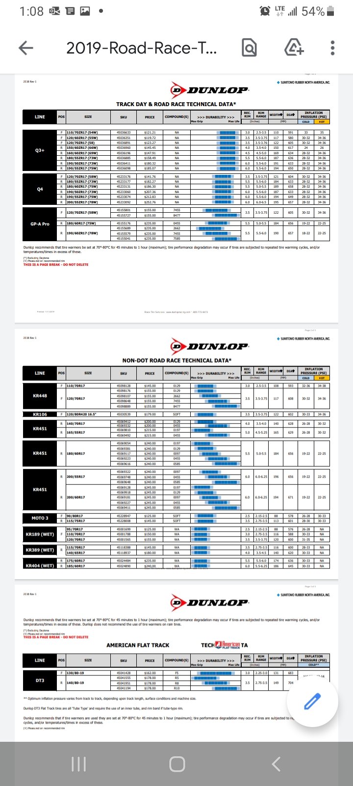

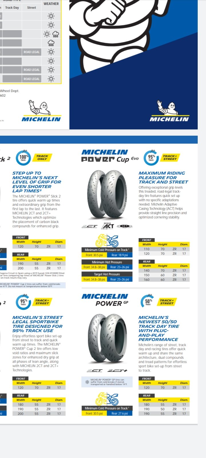

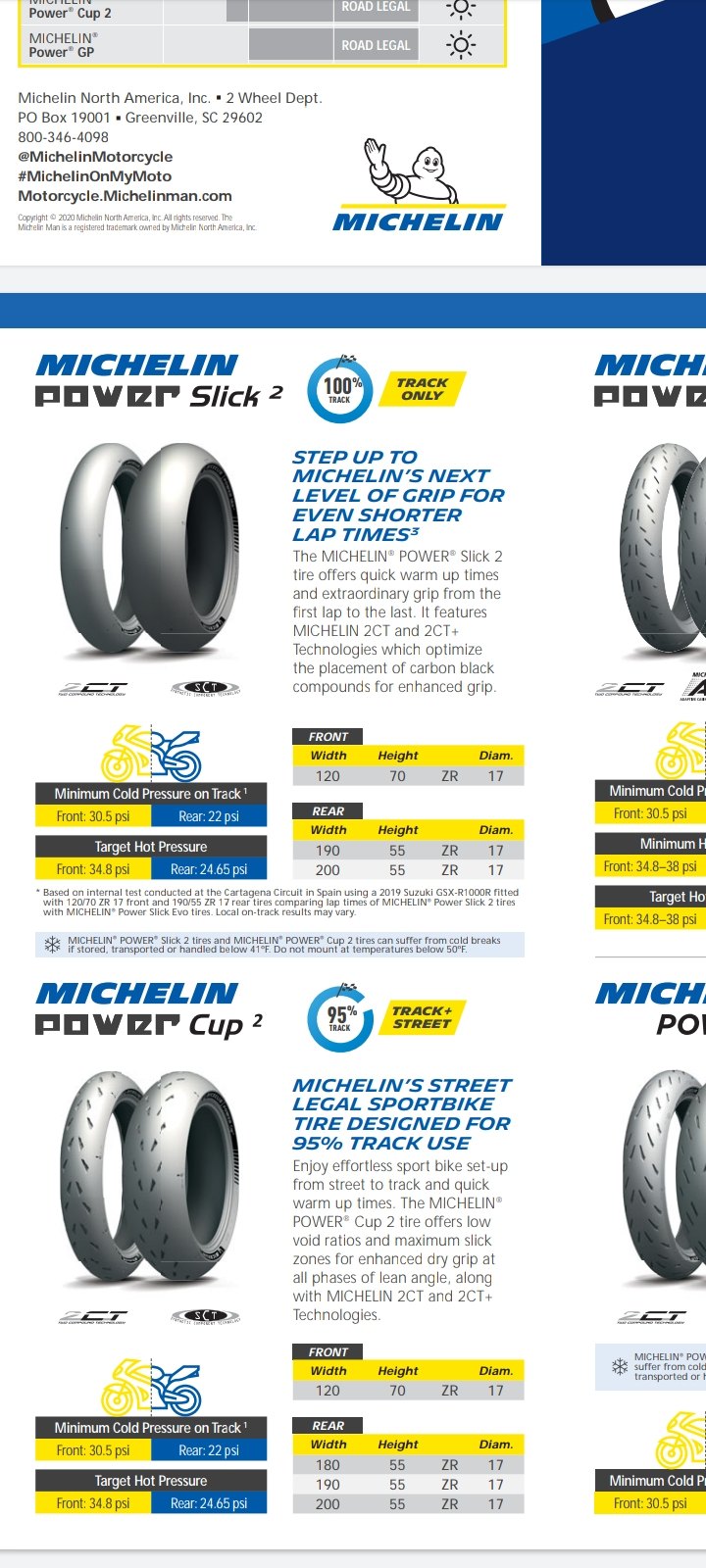

tomek Posted September 27, 2021 Posted September 27, 2021 (edited) Tire pressure? It depends on many, many factors. Many if not most of real performance tires run higher pressures in the front. Edited September 27, 2021 by tomek Quote
superhawk996 Posted September 28, 2021 Posted September 28, 2021 17 hours ago, tomek said: Tire pressure? It depends on many, many factors. Many if not most of real performance tires run higher pressures in the front. Are there similar charts for street sport tires? I've always assumed that the rear could be run with less than the front just based on their size, but since all the factory recommendations are for more in the rear I assumed I was ignorant to something. Just about every Jap sport bike I've looked at recommends 36/42. The Ducs I had with the same size tires recommended lower, and from memory the F&R pressures were closer to each other. Quote

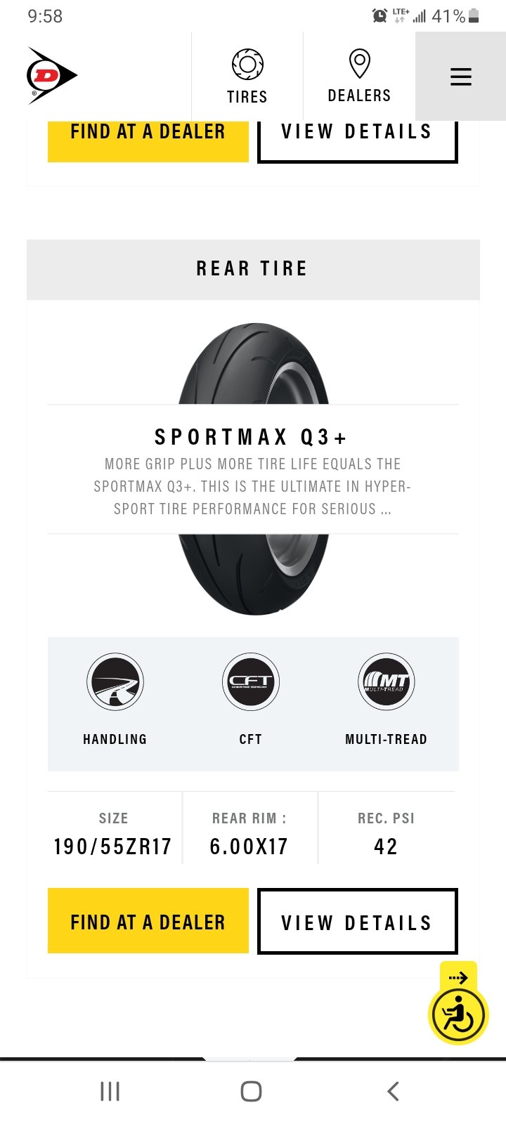

tomek Posted September 28, 2021 Posted September 28, 2021 2 hours ago, superhawk996 said: Are there similar charts for street sport tires? I've always assumed that the rear could be run with less than the front just based on their size, but since all the factory recommendations are for more in the rear I assumed I was ignorant to something. Well, Dunlop Q3+ is a sport street tire, and good choice for up to mid level intermediate track riders. It is also recommended optional for my street VFR12 per Dunlop official web page. If you look at first chart from my previous post they recommended 28-32 cold, or before riding, air pressure. However, if you use tire search option from their page you end up with this. Quote
