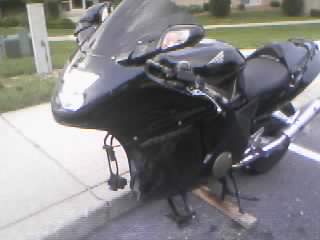

Hobicus Posted December 10, 2007 Posted December 10, 2007 You just can't get a better write up than that. Did you do any work today? That took me an hour. I was officially doing "Paperwork". It could have had pictures... (no comments on the messy garage) These were taking when I was restoring the 97 XX. Normally you wouldn't take off the upper and lower cowl Front wheel off, block of wood under oil pan Looking down from the triple trees. Loosening the fork caps Pumping the cartridge rod to fill with oil Pumping out the excess oil. Notice the white piece of wire hanging over the edge of the fork tube. Measuring fork tube height Replacing the handlebars Quote

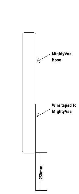

pcinpdx Posted April 22, 2008 Posted April 22, 2008 Hobi, I'm pretty sure I understand but want to double check with you on refilling the fork tubes. If using the overfill method do I create an apparatus that looks something like this: I take it that I would insert this into the fork tube until it touches bottom and then suck out everything to the bottom of the MightyVac tube which would be right at the 230mm mark - correct? Quote

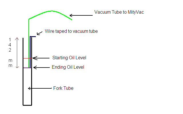

Hobicus Posted April 23, 2008 Posted April 23, 2008 Hobi, I'm pretty sure I understand but want to double check with you on refilling the fork tubes. If using the overfill method do I create an apparatus that looks something like this: I take it that I would insert this into the fork tube until it touches bottom and then suck out everything to the bottom of the MightyVac tube which would be right at the 230mm mark - correct? No.... You're not measuring from the BOTTOM, you are measuring from the TOP Here's a picture: (Edit: Changed 230 to 142, according to manual) Quote
pcinpdx Posted April 23, 2008 Posted April 23, 2008 Sweet. Thanks for the quick response and setting me straight. It's all making perfect sense now. Quote
Redbird Posted April 23, 2008 Posted April 23, 2008 You might check that 230mm number, too. I know there were were changes to the specs which included fork oil level, but I'm pretty sure my '01 was supposed to be set at 140mm. Check the manual and make sure you've got the specs for your model year before buttoning it up. Quote

pcinpdx Posted April 23, 2008 Posted April 23, 2008 You might check that 230mm number, too. I know there were were changes to the specs which included fork oil level, but I'm pretty sure my '01 was supposed to be set at 140mm. Check the manual and make sure you've got the specs for your model year before buttoning it up. Thanks for the tip. I'll definitely consult the manual to make sure I've got the right numbers I did mine the lazy way and just removed the bolt on the bottom of the tubes and pumped the forks. I'm almost positive that's what I'll do next time but if I can tear it down, see how it works and put it back together again without majorly fucking something up, it gives me some sense of accomplishment. Quote
Hobicus Posted April 23, 2008 Posted April 23, 2008 You might check that 230mm number, too. I know there were were changes to the specs which included fork oil level, but I'm pretty sure my '01 was supposed to be set at 140mm. Check the manual and make sure you've got the specs for your model year before buttoning it up. Tim is correct... I just checked my manual (as promised months ago, but I got lazy) and the number for 99-03 is 142 MM, or 5.6 IN, not 230 as previously posted. I've edited the original instructions, and will update the graphic shortly. Quote
lexxus Posted April 23, 2008 Posted April 23, 2008 I've been doing it this way, All the time My bike,Full fairing, forks off, is the only way i change my fork oil. Quote
