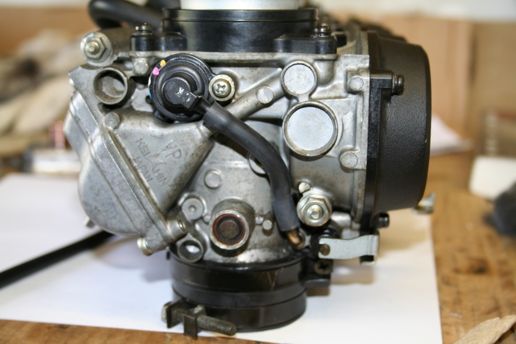

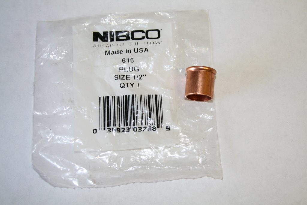

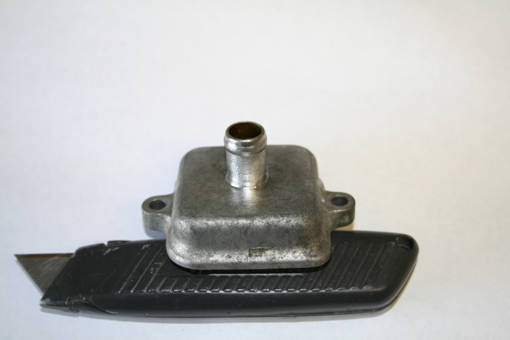

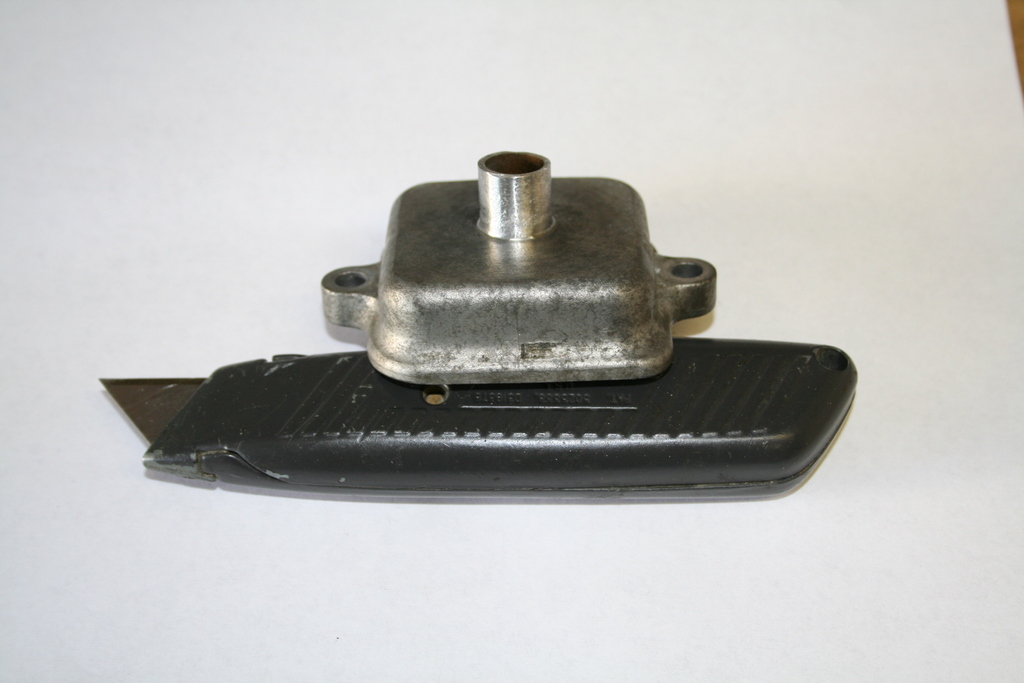

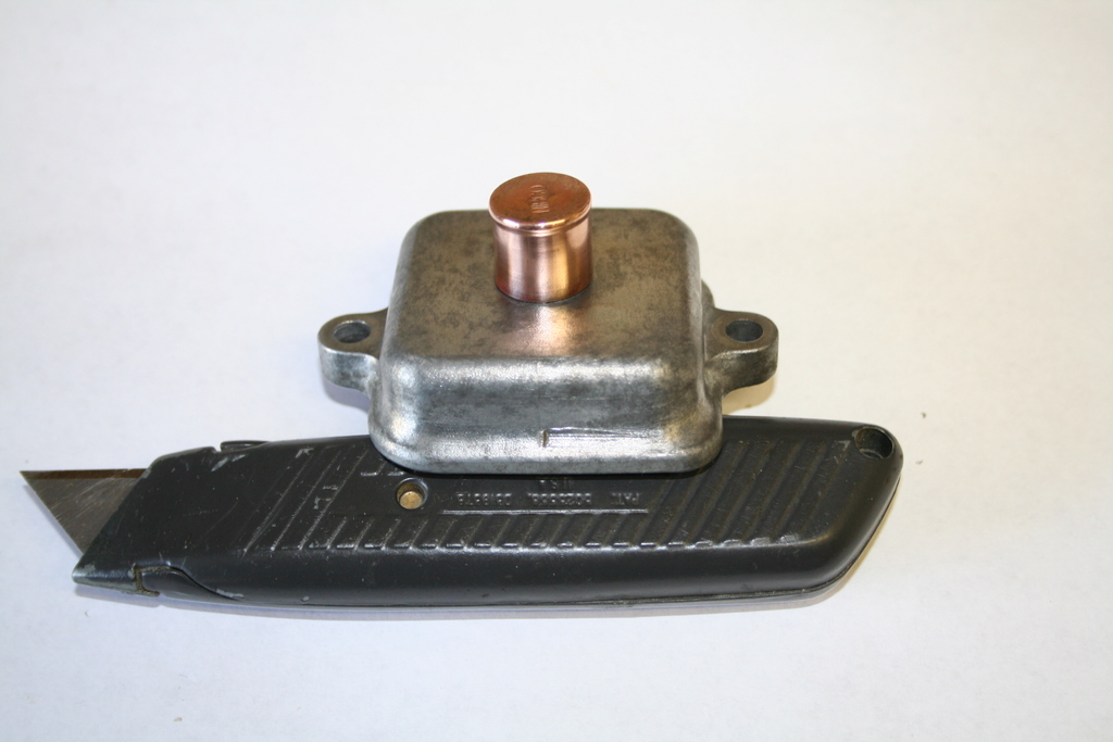

MrBadExxample Posted October 20, 2007 Posted October 20, 2007 Step 0. Reed Valve Cover - before modification Step 1. Cut away the bulge at the top. Takes about 30 seconds with a cut-off wheel on a dremel tool. Step 2A. 1/2" copper plug. $3.00 in the plumbing section of Lowes. Step 2B. Heat copper plug with a propane torch and tap over the snout. It's a very tight fit. I couldn't get the cap on without heating it. Step 3. Cap the airbox opening that feeds the PAIR valve Step 4. Connect the two vacuum ports on the carbs that supply vacuum to the PAIR valve. Step 5. Go destroy the environment just so you can have a cleaner cylinder head. Quote

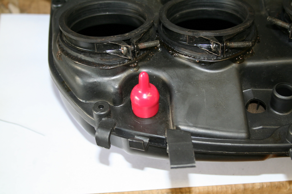

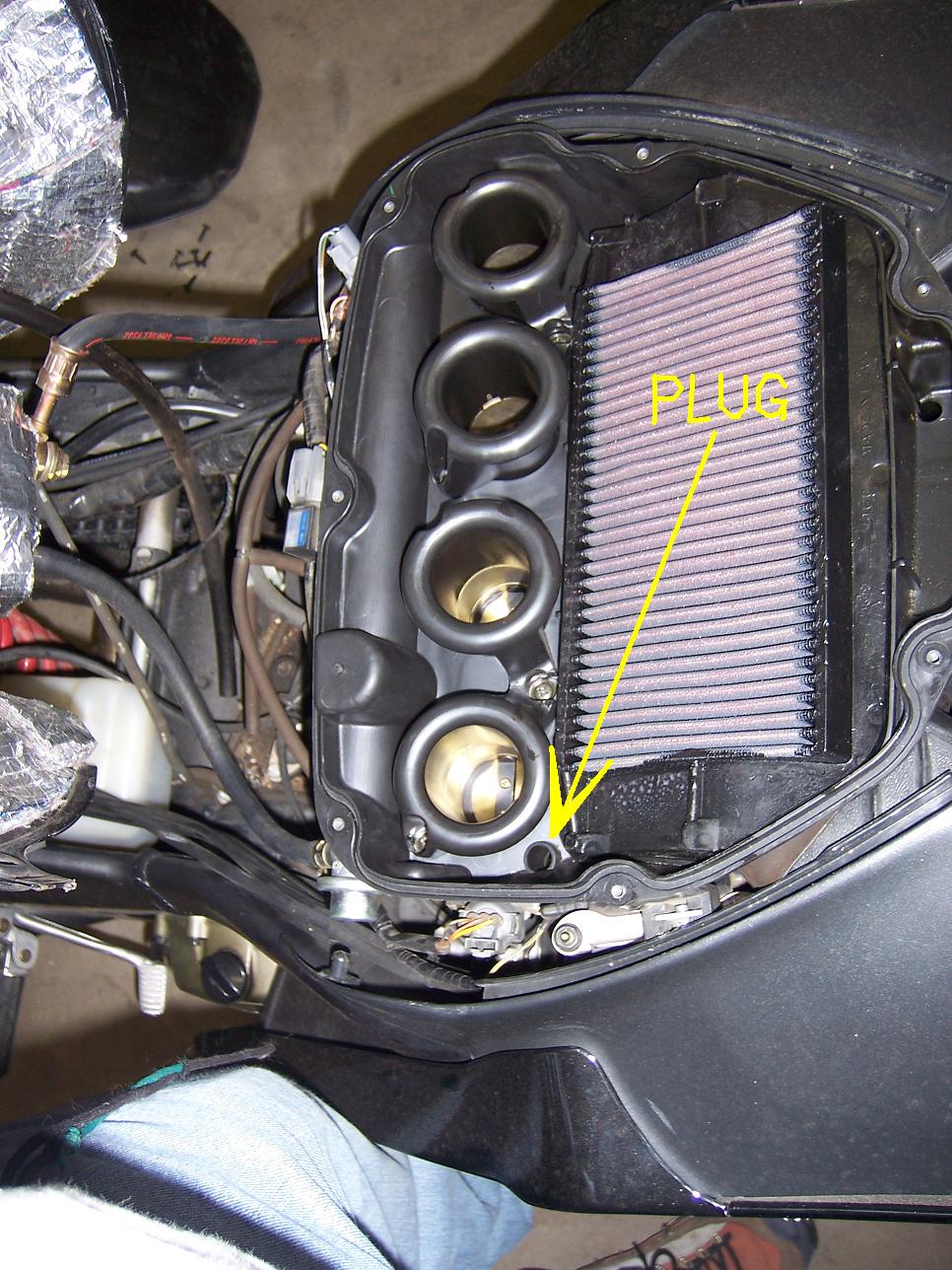

DrDyno Posted October 27, 2007 Posted October 27, 2007 THIS is the cheapest, easiest method of blocking off the PAIR System, using a 1/2" rubber expansion plug. Courtesy of EVLXX: Quote
MrBadExxample Posted October 27, 2007 Author Posted October 27, 2007 THIS is the cheapest, easiest method of blocking off the PAIR System, using a 1/2" rubber expansion plug. Courtesy of EVLXX: True, if you don't mind leaving the PAIR plumbing in place. Then why do PAIR elimination at all? Quote

EVLXX Posted October 28, 2007 Posted October 28, 2007 THIS is the cheapest, easiest method of blocking off the PAIR System, using a 1/2" rubber expansion plug. Courtesy of EVLXX: Hey... there's that picture... I was looking for that one. Another member asked me about that a while ago.. and I couldn't find that picture to show him. Thanks for posting it. Also.. I should add, the purpose of just plugging that hole, is to disable the PAIR system for Dyno testing without haveing to spend a bunch of time and money removing the entire system. Quote

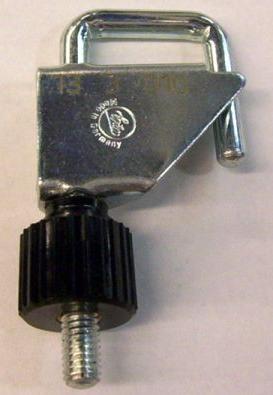

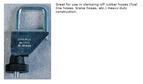

OZDave Posted October 28, 2007 Posted October 28, 2007 THIS is the cheapest, easiest method of blocking off the PAIR System, using a 1/2" rubber expansion plug. Courtesy of EVLXX: Hey... there's that picture... I was looking for that one. Another member asked me about that a while ago.. and I couldn't find that picture to show him. Thanks for posting it. Also.. I should add, the purpose of just plugging that hole, is to disable the PAIR system for Dyno testing without haveing to spend a bunch of time and money removing the entire system. ...or you could just clip the hose. It's a lot easier. :icon_silenced: Quote

EVLXX Posted October 28, 2007 Posted October 28, 2007 Why does it increase HP? Or maybe the question should be.. Why does the PAIR system hurt HP? Because the PAIR system dilutes the exhaust flow with a COOL charge of fresh air. This really screws up power for a couple reasons. First the air is heavier than the exhuast gases, so it slows the particle flow down. And sencondly it's cold, which further slows the gases down inside the exhaust system. So put simply, the cooler and heavier the exhaust gases are, the slower it travels, which equals increased backpressure, which equalls less power. THIS is the cheapest, easiest method of blocking off the PAIR System, using a 1/2" rubber expansion plug. Courtesy of EVLXX: Hey... there's that picture... I was looking for that one. Another member asked me about that a while ago.. and I couldn't find that picture to show him. Thanks for posting it. Also.. I should add, the purpose of just plugging that hole, is to disable the PAIR system for Dyno testing without haveing to spend a bunch of time and money removing the entire system. ...or you could just clip the hose. It's a lot easier. :icon_silenced: With what ? What's you smokin ? Quote

OZDave Posted October 29, 2007 Posted October 29, 2007 Why does it increase HP? Or maybe the question should be.. Why does the PAIR system hurt HP? Because the PAIR system dilutes the exhaust flow with a COOL charge of fresh air. This really screws up power for a couple reasons. First the air is heavier than the exhuast gases, so it slows the particle flow down. And sencondly it's cold, which further slows the gases down inside the exhaust system. So put simply, the cooler and heavier the exhaust gases are, the slower it travels, which equals increased backpressure, which equalls less power. THIS is the cheapest, easiest method of blocking off the PAIR System, using a 1/2" rubber expansion plug. Courtesy of EVLXX: Hey... there's that picture... I was looking for that one. Another member asked me about that a while ago.. and I couldn't find that picture to show him. Thanks for posting it. Also.. I should add, the purpose of just plugging that hole, is to disable the PAIR system for Dyno testing without haveing to spend a bunch of time and money removing the entire system. ...or you could just clip the hose. It's a lot easier. :icon_silenced: With what ? What's you smokin ? With one of these. What do you think you'd clip a hose with? Maybe you need a smoke? Quote
SR71BLACKBIRDXX Posted October 29, 2007 Posted October 29, 2007 With what ? I think Ive got a couple of these kicking around... Quote
