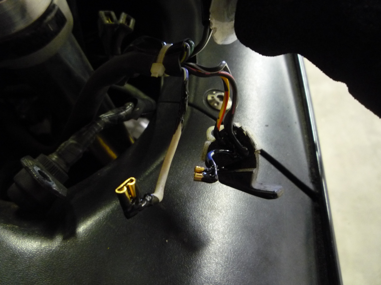

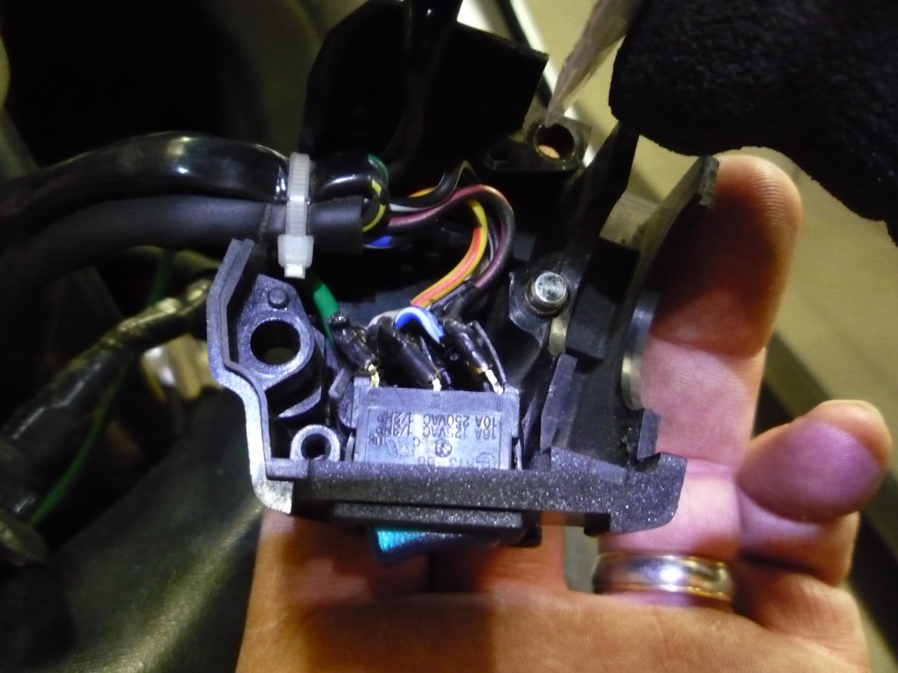

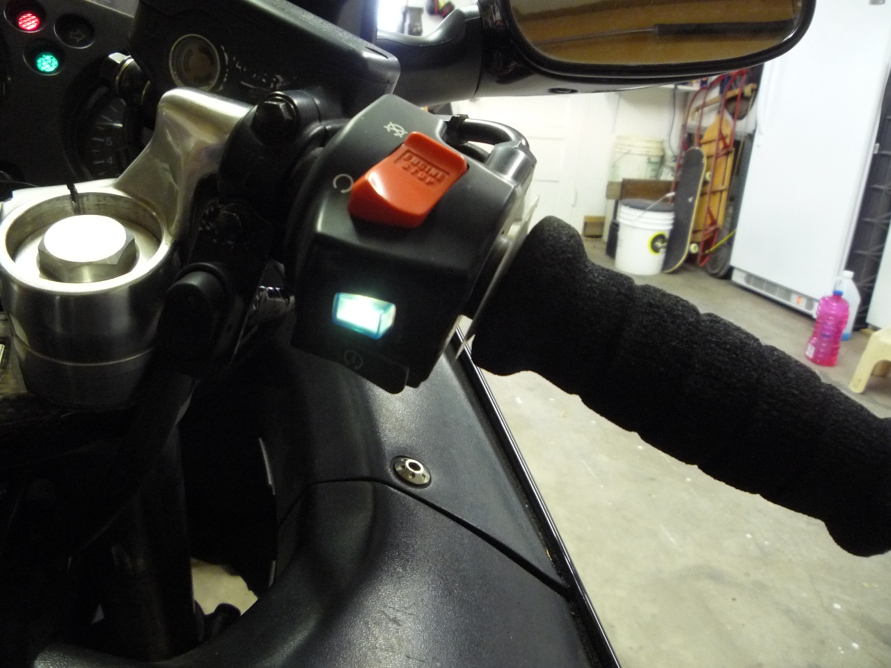

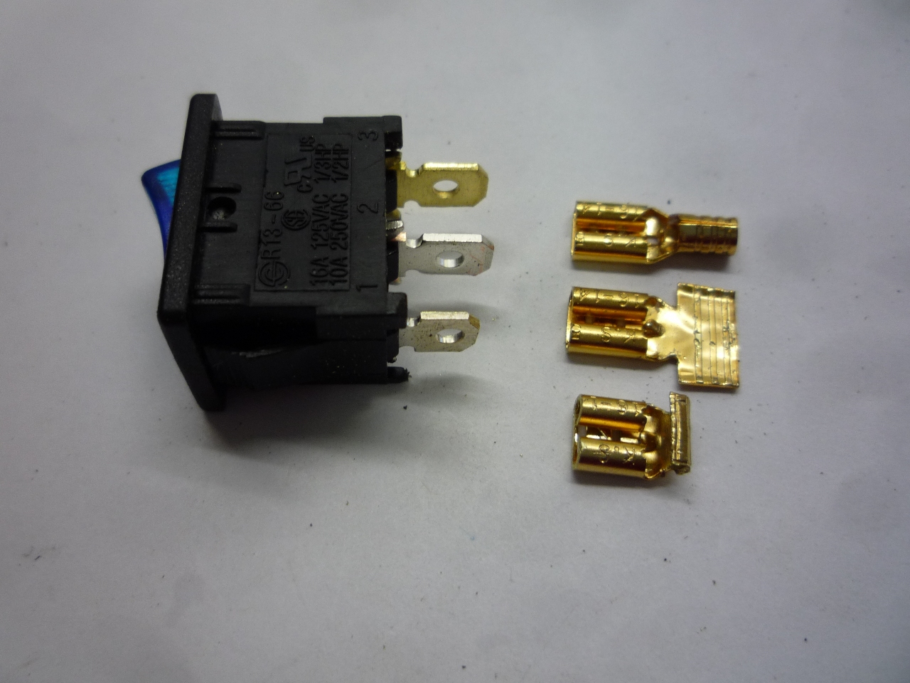

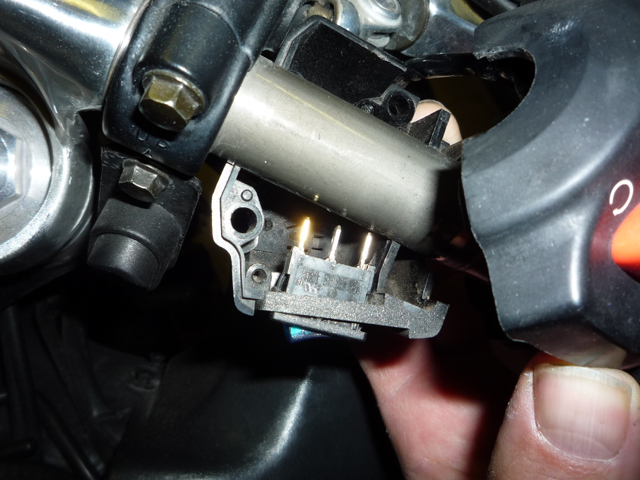

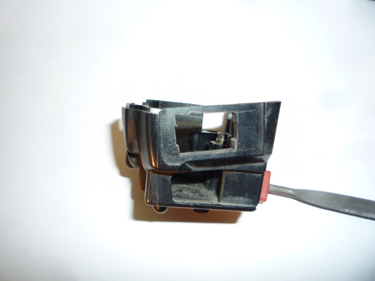

EVLXX Posted March 11, 2010 Share Posted March 11, 2010 Wanted a Euro switch, Didn't want to wait for one, nor pay for it, then after talking with Stan about his, new I could make my own. Pictorial... Edited to add: First things first. I looked at the Wiring Diagram, after talking with Stan. He said the wiring for the Euro switch is in all models, and that it's the Blue/white stripe wire. The diagram shows a Bu/W wire coming off the Starter switch, and going to the Low beam Headlight, and to the High Low switch. ( From the Hi/Lo switch it changes to a Blue wire, then travels to the Headlight relay, which powers the High Beam. So, what this means is, that if you cut Blue/white wire, and put a Switch in it, you'll have your Headlight On/Off (euro) switch. Stan also told me that all of the right control housing have the room and space for the switch. Which completely makes sense when you consider production costs, etc. So I decided I wanted, the switch in the right control housing, and that I just needed to find a small switch and make it happen. A trip to my local Auto parts store, and I had a Mini Blue lighted Rocker switch for $3.99, and set package of .185 female blade connectors $ 2.??, + tax. 1st picture, after taking off the lower half of the housing, and carefully drilling, and filling out the needed hole in the housing, we have a switch socket. (note the rocker switch is wider on the top than the bottom, I took my time and made it fit almost perfectly) 2. A trial fit of the switch, revealed, the blades were already contacting the Bar assembly. OK, some finangling is going to be needed to fit the blade connector onto the blades and have room for wires as well. 3. So I decided to shorten all of the Blades and all of the Connectors to match. A small metal file works best here, especially because a sander or grinder could cause to much heat and damage the switch. After filling down the connector, I also flattened out the wire crimp sleeve, and made it so that I could soder the wire on at a perpendicular angle. All of this was needed to make the switch fit into the housing. 4. I cut the Bu/W wire coming of the Starter switch about 1 inch back, this would give me just enough room to attach the blade connector and tuck it in the housing above the starter switch. I then added about 1.5 inches of white wire to the out bound Bu/W wire, again this is just enough wire to tuck in, around and under everything. Then I coated all the connection with multiple coats of Liquid Tape. ( this took a while since the Liquid tape takes 4 hours to fully dry. ) 5.After adding a green ground wire, for the lighted switch to work, and another test fit, I found I still needed just a little more room, so I bent the blades on the switch forward. This just, and I mean just, let everything fit into the housing and not touch the housing wire protection plate that's inside the housing ( not shown), and not touch the bar either. Then I decided just for an added bit of security, I would put a piece of semi tough plastic over the switch, in-between the wires and the metal parts. The clear plastic case the blade connector came in worked great. 6. All done and Headlights off. I know the picture is kinda dark, I was haveing problems with the flash on tha camera and all. Maybe tomorrow or sometime, I'll take a better picture outside, to give you a better view of just how well it looks. 7. Headlights On. Perfect, and easy to understand, day or night. With all that said, yes I could have just cut into the Bu/W wire outside of the housing, and put a switch inline, and mounted it anywhere, A-Lot easier, but I want it to look like it was factory. So for about $10 anybody can have there own Euro Headlight switch. Link to comment Share on other sites More sharing options...

Keith Posted March 11, 2010 Share Posted March 11, 2010 Yes, I'd like more info on the "blue/white" wire. Are they already in the switch housing or did you bring them in from somewhere else? A little bit of a circuit/hook up diagram, even a crude one, would be quite helpful. Good looking modification job. Link to comment Share on other sites More sharing options...
EVLXX Posted March 12, 2010 Author Share Posted March 12, 2010 Sorry for the lack of extra info, I've been a little busy with multiple projects (just finish another HID install on a friends vehicle), etc. and just wanted to get it posted. I'll edit the first post with more info when I get a chance, and maybe a brighter picture with the switch in the off position. Link to comment Share on other sites More sharing options...
Byrdman Posted March 12, 2010 Share Posted March 12, 2010 Looks good Eric. I like how you cut down the terminals to make it fit. Link to comment Share on other sites More sharing options...

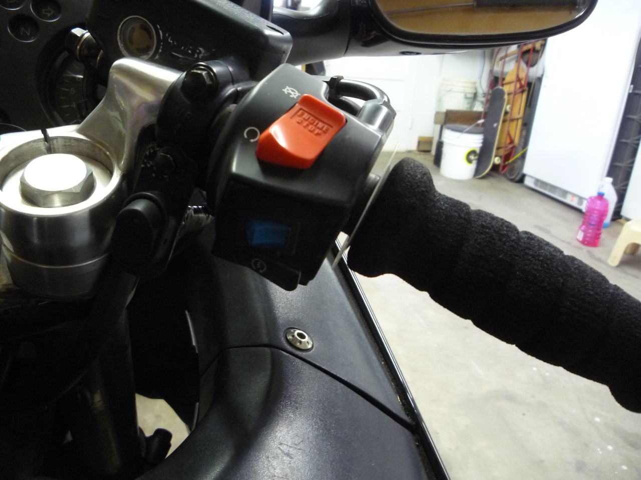

cbrxxquad Posted March 12, 2010 Share Posted March 12, 2010 Great job and write up, Eric. So I guess it works, lol. Link to comment Share on other sites More sharing options...
EVLXX Posted March 12, 2010 Author Share Posted March 12, 2010 So I guess it works, lol. LOL. So you caught that I didn't have the bike on in pic # 6, did ya. That is funny. And yes, the switch and Headlight both turn on together. I just didn't have a big mirror handy to show you both of them at the same time. (Aaaa...but did you catch what's missing, In the last 2 pics ? It's not in any of the first pics either, you would just have to either figure it out, or know that I usually have one on the bike. Yes, one project creates another one. Now I have a New project. LoL.) Link to comment Share on other sites More sharing options...
