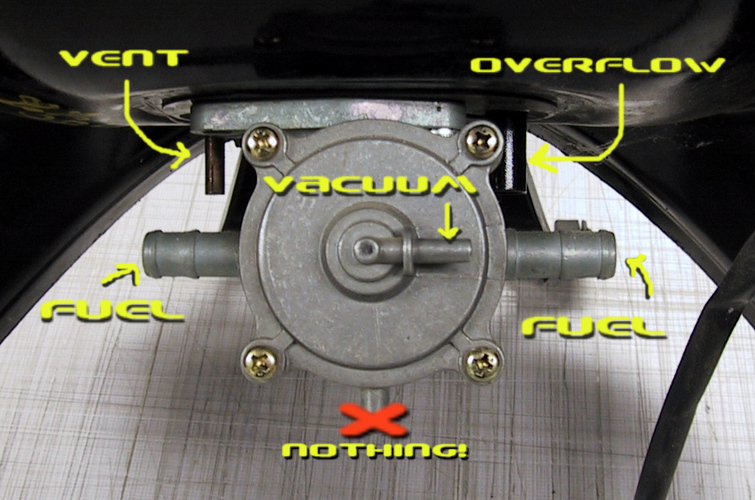

xxexcess Posted January 10, 2007 Share Posted January 10, 2007 in the process of doing the plugs and air filter, having taken the tank off (98 carb) i have got a small bore Y shaped hose that goes onto the tank and then goes under the bike, but i still have one part of this Y pipe that doen't seem to connect to anything, any ideas??? is it simply a breather for the tank/overflow?? Oh and the plugs are easy to do with tank off, the original honda plug tool, 1/4 sq drive 10mm socket. thanks iain Quote Link to comment Share on other sites More sharing options...
airborneXX Posted January 10, 2007 Share Posted January 10, 2007 On mine there's the vacuum tube from the cylinder head to BACK of the petcock The fat tube is the overflow and just hangs down, and there's a smaller (same size as the vacuum tube) that also just hangs down from the tank. Quote Link to comment Share on other sites More sharing options...

airborneXX Posted January 10, 2007 Share Posted January 10, 2007 On mine there's the vacuum tube from the cylinder head to BACK of the petcock The fat tube is the overflow and just hangs down, and there's a smaller (same size as the vacuum tube) that also just hangs down from the tank. If by "BACK" you mean front, you're right on Brett. Damn busted :icon_doh: How's this... don't hook the vacuum line to the port coming out of the bottom of the petcock Quote Link to comment Share on other sites More sharing options...
xxexcess Posted January 11, 2007 Author Share Posted January 11, 2007 Thanks so i guess the other part of y tube is simply a breather iain Quote Link to comment Share on other sites More sharing options...

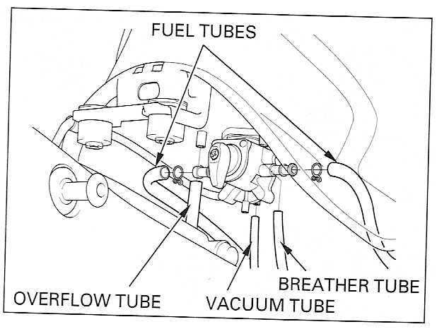

kiwimack Posted January 11, 2007 Share Posted January 11, 2007 Thanks so i guess the other part of y tube is simply a breather iain I have the tank off my 97'. I have a tee connector on the vacum line but it is/was for the scott oiler(which I am removing) there are no other 'T' or 'y' connections.......... as per the diagram . good luck with it. mack Quote Link to comment Share on other sites More sharing options...
xxexcess Posted January 11, 2007 Author Share Posted January 11, 2007 Having now checked this out further, it seems my Y pipe is absolutely right however there is no answer as to Y it's like this, thanks guys for the help iain Quote Link to comment Share on other sites More sharing options...

BeerXX Posted March 22, 2007 Share Posted March 22, 2007 Having now checked this out further, it seems my Y pipe is absolutely right however there is no answer as to Y it's like this, thanks guys for the help iain On the pics on US models the bottom tap it says nothing, but the T on the breather on European models goes to the tap on the bottom of the petcock. Quote Link to comment Share on other sites More sharing options...
