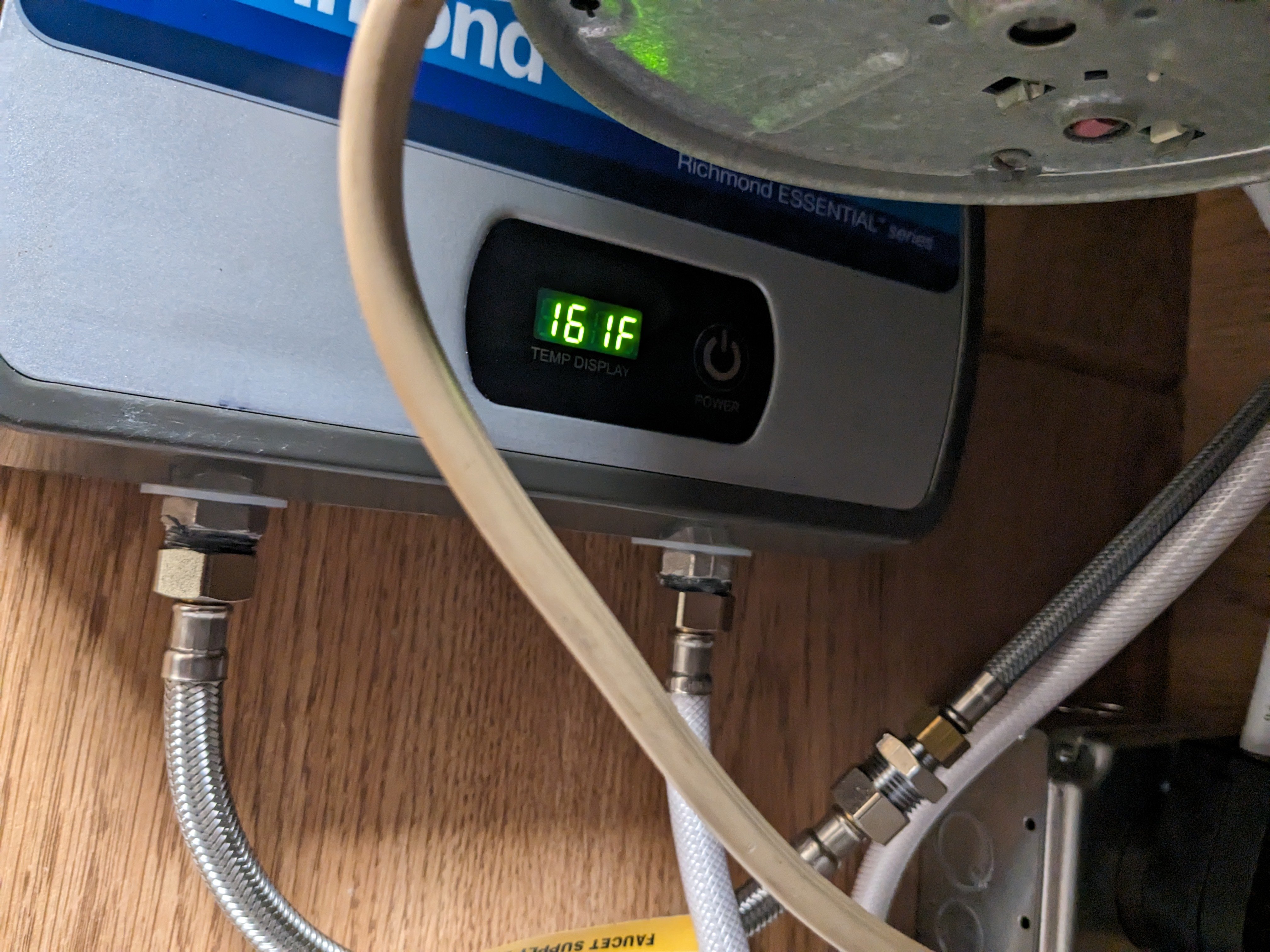

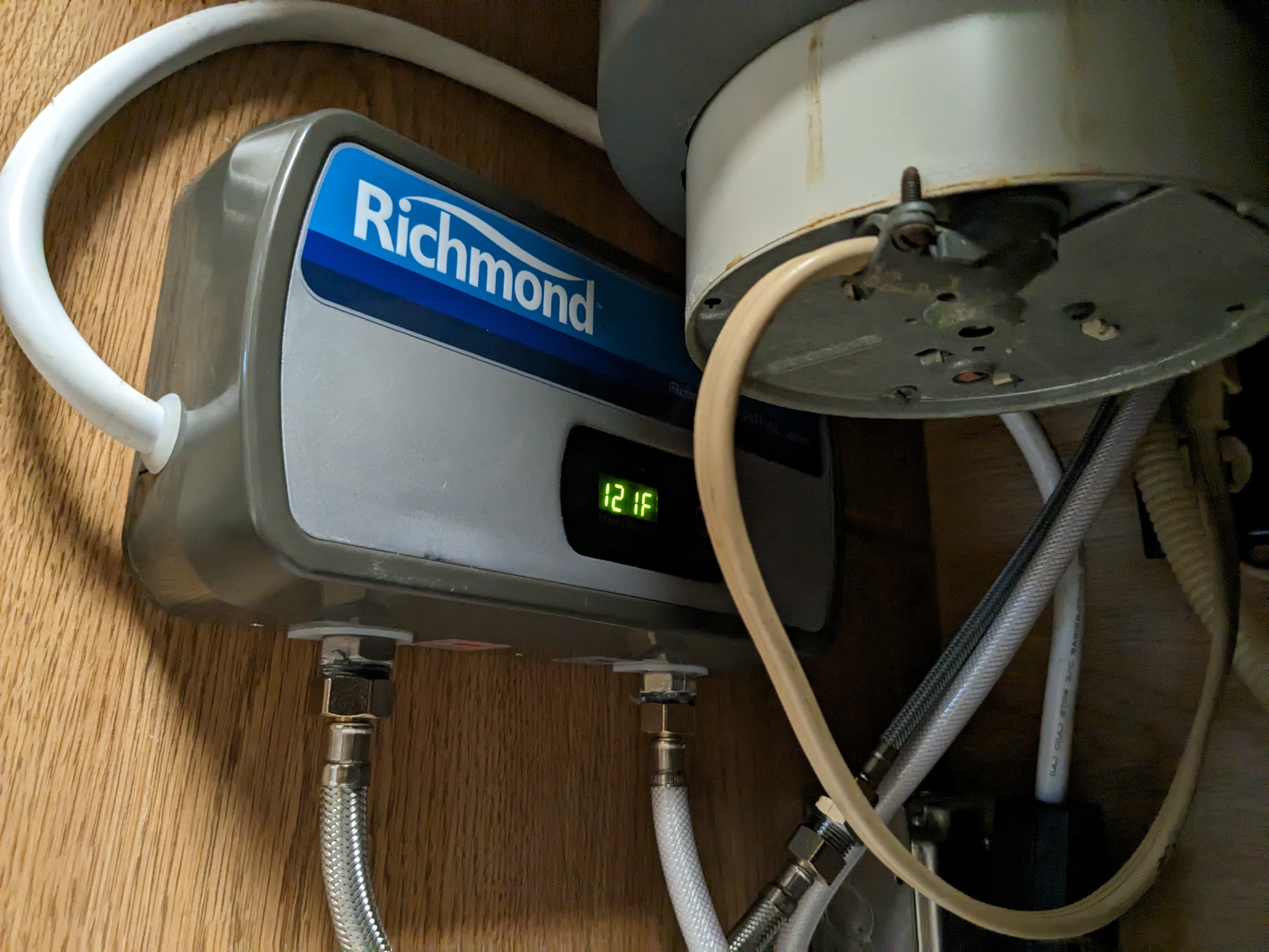

XXitanium Posted September 6 Author Share Posted September 6 It made hot water like mad. From what I can tell a tops out of 161°. After my wife got done running water for the dishes, the new breaker tripped. Everything is new, including the breaker all the way to the new power outlet. ? Quote Link to comment Share on other sites More sharing options...

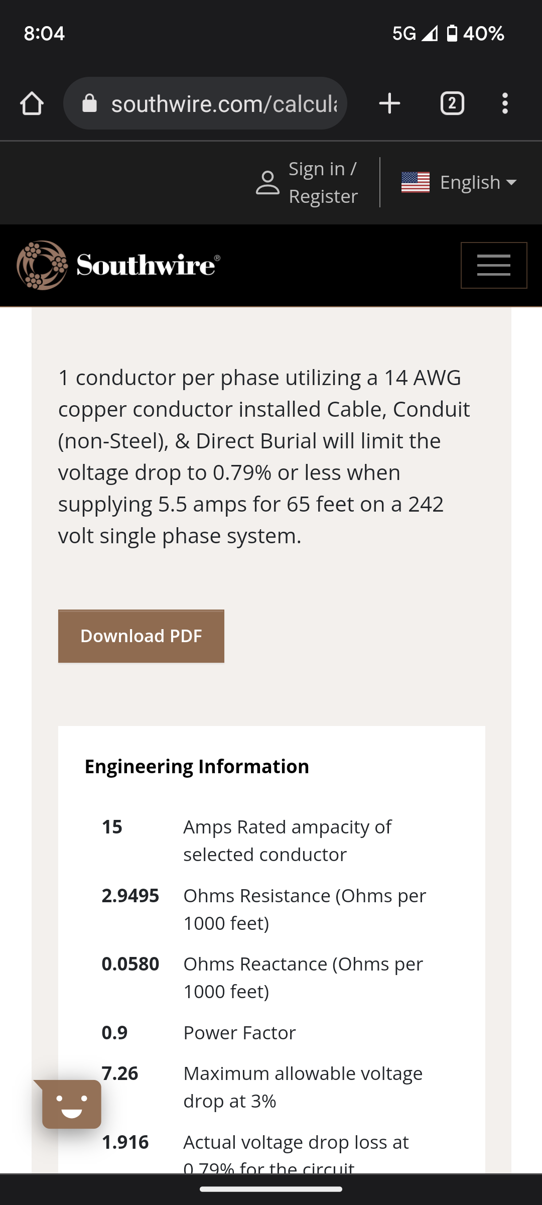

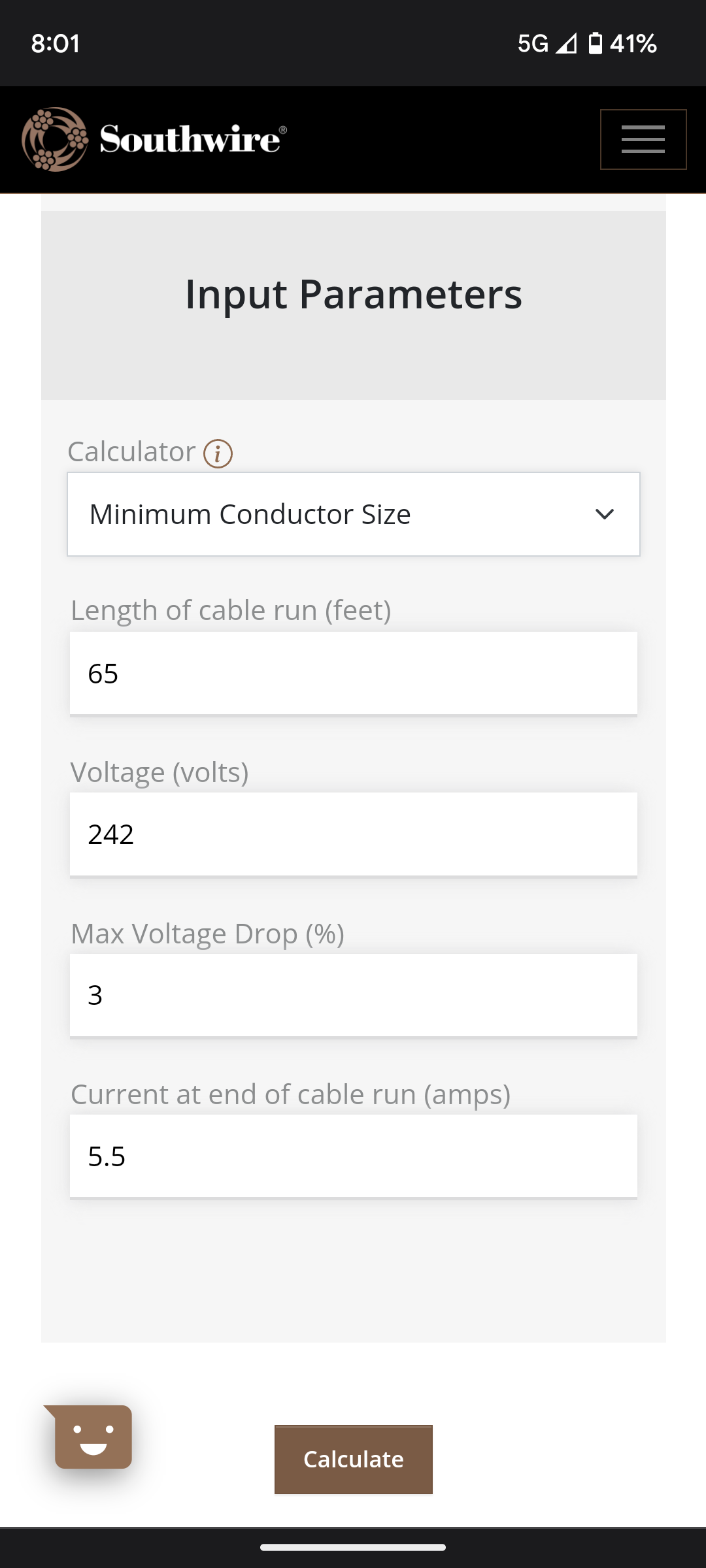

XXitanium Posted September 6 Author Share Posted September 6 (edited) We put in #8. Measured volts was 242V. ...allowed to vary 5%, my understanding. https://www.southwire.com/calculator-vdrop Edited September 6 by XXitanium Quote Link to comment Share on other sites More sharing options...

CALCXX Posted September 6 Share Posted September 6 My hot water heater is only about 25 feet away. I re-plumbed the house about 15yrs ago with Aqua-Plex. Made a big difference replacing all that copper tubing and iron pipe. Hot water much faster even in winter. and yeah 161 is pretty damn hot. Are you sure it's a fixed set point? Quote Link to comment Share on other sites More sharing options...
Furbird Posted September 6 Share Posted September 6 Interesting. All of my hot water valves are on one main wet-wall with the exception of the washing machine. Mom and dad have the exact opposite problem as their water heater was in the utility room right next to the washing machine; on the other end of the house from the bathrooms. Of course when they added on their new bathroom is right there too so they're not worried about this problem anymore. This could have come in handy 40 years ago when we had to wait 2 minutes for hot water when we came in to wash our hands for dinner! Quote Link to comment Share on other sites More sharing options...
XXitanium Posted September 6 Author Share Posted September 6 2 hours ago, CALCXX said: Are you sure it's a fixed set point? No, I'm not, but an external valve I could adjust without taking the case off the water heater. I may have wired it too high a voltage? https://www.richmondwaterheaters.com/product/Richmond-Essential-Point-of-Use-Tankless-Electric-Water-Heater/ Quote Link to comment Share on other sites More sharing options...

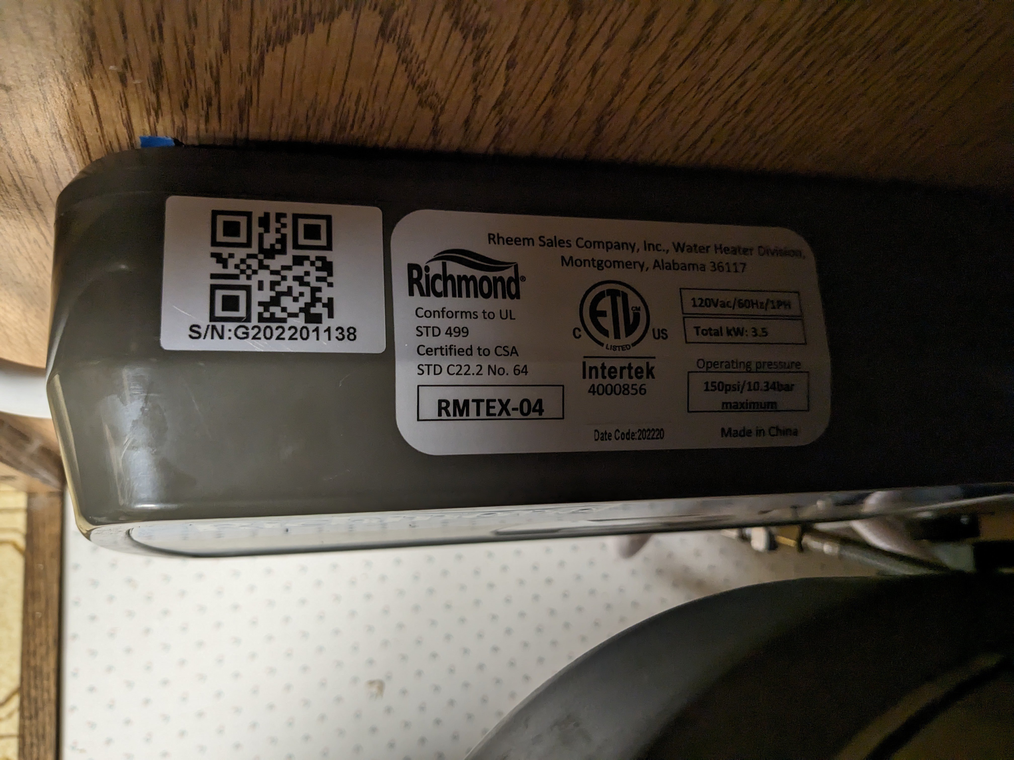

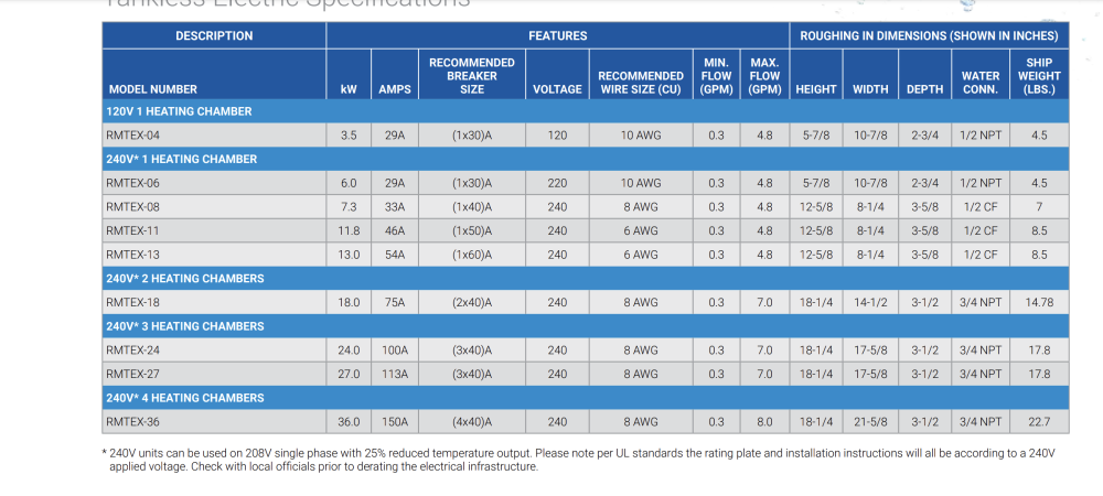

CALCXX Posted September 6 Share Posted September 6 (edited) Bill, the name plate reads 120V. Hmmmm Is there another diagram undercover in the make up box showing the taps and elements in series or parallel ? It must have a thermostat also. Adjusted where? I would be surprised if it is fixed at 161. Edited September 6 by CALCXX 1 Quote Link to comment Share on other sites More sharing options...

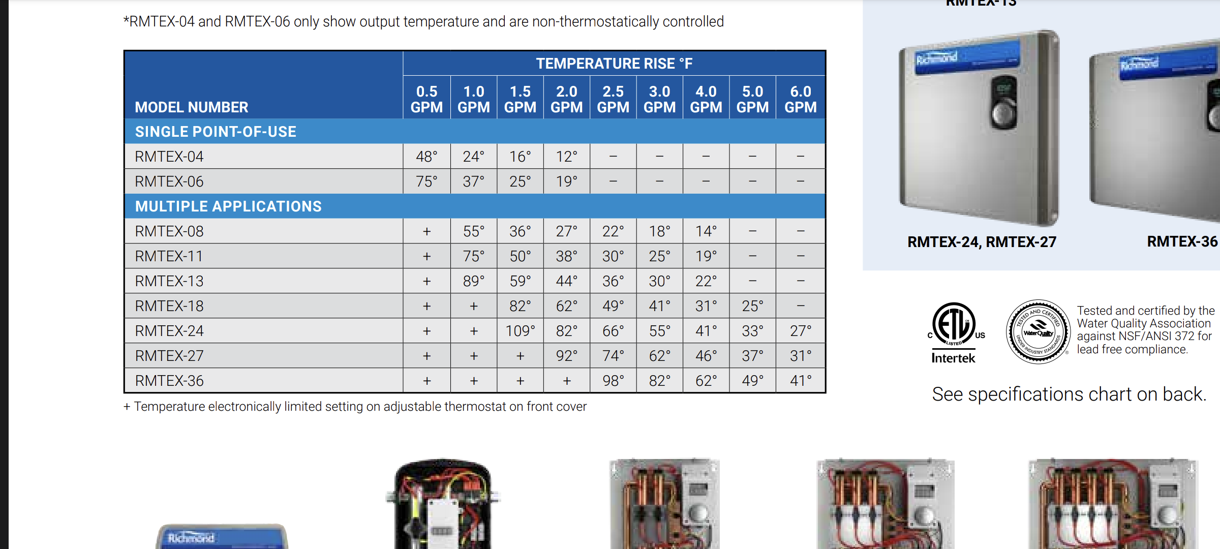

XXitanium Posted September 6 Author Share Posted September 6 Hmmm, looks like I applied too much turbo boost. How long till it turns into a fuse? "RMTEX-04 and RMTEX-06 only show output temperature and are non-thermostatically controlled” ...maybe I just turn off the breaker till I can rewire it? Quote Link to comment Share on other sites More sharing options...
XXitanium Posted September 6 Author Share Posted September 6 It may be easier to just grab a bigger model with temperature settings too. Quote Link to comment Share on other sites More sharing options...

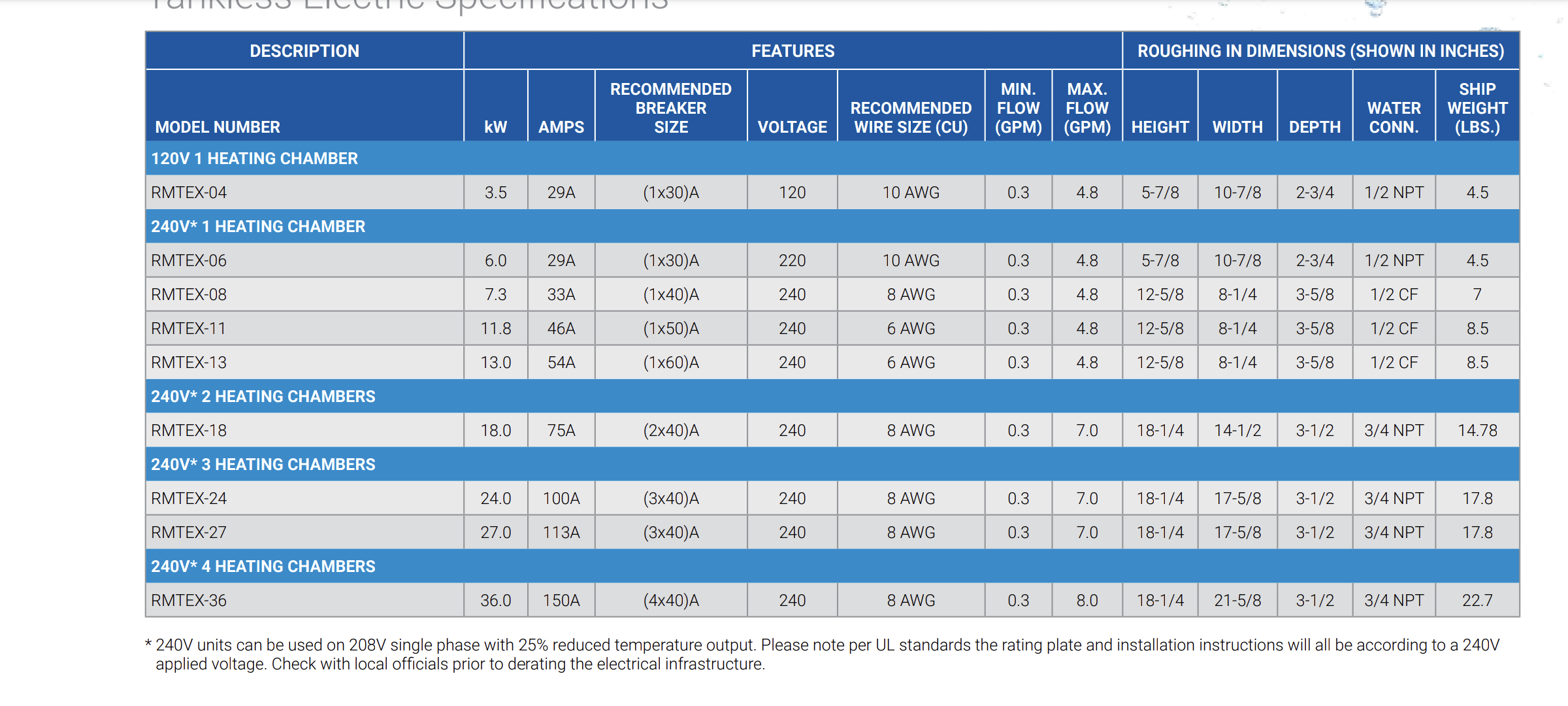

CALCXX Posted September 6 Share Posted September 6 (edited) Bill, I see the model -04 does not have a thermostat. More like an Insta-hot for making tea. You are supplying it with twice the voltage beyond the nameplate rating. Turn it off and get control of it. If you are going to keep it, have the Electrician come back and move one phase off the 2-P breaker back to Neutral and supply it with 120. Your chart shows 1P 30A breaker 10ga wire minimum. Edited September 6 by CALCXX Quote Link to comment Share on other sites More sharing options...
SwampNut Posted September 6 Share Posted September 6 And if they put in a neutral by chance, don't just wire off one phase and the neutral on a split phase breaker, not safe. Quote Link to comment Share on other sites More sharing options...
