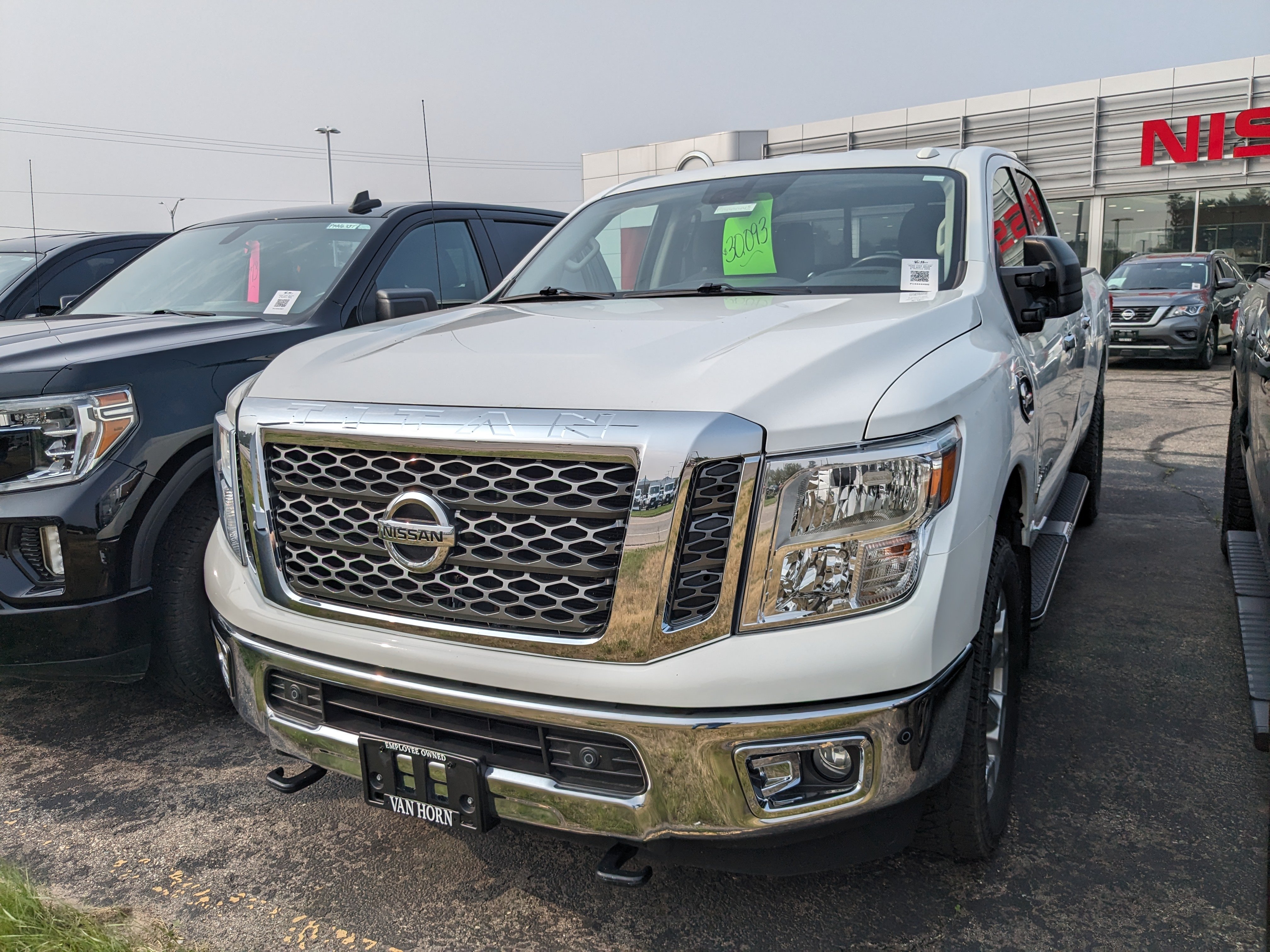

XXitanium Posted July 11 Share Posted July 11 I drove through a couple of lots looking for a Corvette, and this is what I stopped in front of. I know I'm confused somehow... ...somehow... Quote Link to comment Share on other sites More sharing options...
