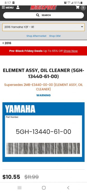

45 minutes ago, tomek said:
It looks like one filter supercedes two different filters, right?
Yup.  They're both the same part # superseding two different part numbers, maybe one of those was a supersede of the other.  There's a bunch of filters that work in place of the motorcycle branded ones.  One of the Bird versions, don't remember if it's the carb or EFI, has a little more room and allows for more options.  I used a Purolator PureOne on one of my Birds but don't remember which.  I think I've also used a Motorcraft, but that might have been a different bike.  PureOne (AKA Motorcraft) are great filters.  Motorcraft are cheap at Walmart, but they only carry the common sellers.  Last I checked the Walmart Supertech filters were from Champion Labs and they were pretty good, especially for the price, but they have visibly changed and I haven't researched them to see if the quality is still there.
